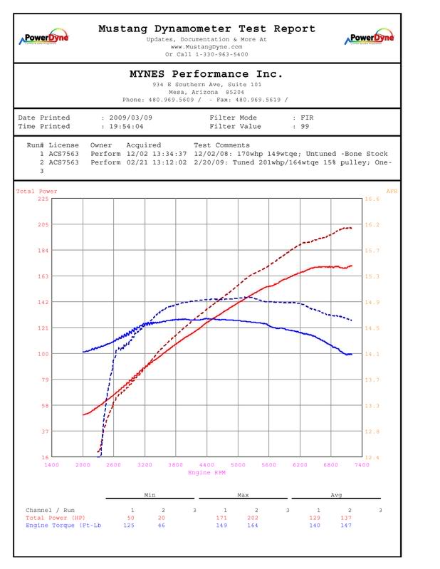

The age-old question goes like this: How much power can i gain from a Custom tune? Answer listed below:
NOTE: For the sake of a fair comparison, we raised the stock Rev Limitor to 7300RPM while not touching the rest of the mapping. If we had kept the stock rev-limitor, then the "DELTA" from our custom tune would be even higher. But we are more interested in comparing "apple to apple" rather than having better looking numbers that do not truly reflect the situation...
Peak HP is typically achieved at 7250RPM... if that was the case, by simply removing the STOCK rev limitor and moving it to 7300 will get you an extra 5-10WHP. But as a tuner, i can't claim that credit as a result of my tuning... and that's probably why my stock MCS is reading "high" on the HP. But if one examines the entire curve, it's evident that the power curve has been moved up at the higher RPM range... now that's the "gain" that i can claimed as the true DELTA of a custome tune
Why Isn't my Torque number higher with a tune? Torque is a directly affected by boost level and engine displacement. Without mechanical changes, the tune can only do so much to increase the Torque number.
WHP WTQE
171 149 Bone Stock (untuned) = We got lucky with our 06 MCS and ended up with a strong "Wednesday" motor
191 153 Bone Stock w/ Custom-Tuned
WHP WTQE

We then installed the 15% Pulley (full stainless steel version) along with the Bosch 550cc injectors and modified the exhaust to "one-ball."
Why the 15% pulley? This is proven to be the most reliable with modest power gains. Very little belt failure (if any) has been reported with the 15% pulley - the same can't be said about the 17% or the 19%.
Why the 550cc Injectors? The common misconception is that 550cc is too big... not really? If the injectors are properly configured and scaled in the ECU Mappings, then they are going to run like stock. In addition, the 550cc can provide additional flow for future upgrades.
HP achived for this mod: 201 WHP & 164 WTQE (+30 WHP, +15 WTQE from BONE STOCK)...
WHP WTQE
201 164 15% Pulley with Bosch 550cc Injectors + "One-Ball"

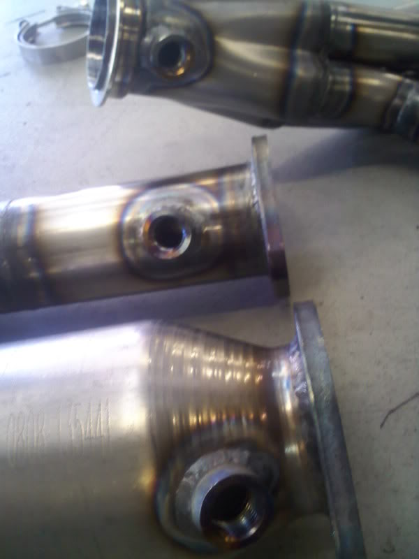

Close-up of the high-flow CAT and Test Pipe:
Welded runners (both inside and outside):
V-Band:
Test Pipe and High-Flow CAT:

171 is a pretty high number for a stock untuned Mini I would think. So you made 20 hp just by tuning, and 10 more with a pulley and a oneball ?
I like the progression of upgrades and how you pre-posted. Nice job.
Will you have pictures of the header?

A quick question. The first plot is of an untuned, stock MCS, but it is revved past the stock rev limiter. Either the RPM on the dyno is incorrect, someone had been in the ECU, or I'm just missing something. What's up?

Mike, why is it in post #2 the stock TQ is above 126lb ft at 6500RPM and in post #3 it is well below the 120 mark at the same RPM? Did you pick and chose runs for comparisons sake? There's a 20hp difference 30 minutes apart on the runs?
EDIT: The description above the graph does not match the two runs listed on the graph itself. The stock "untuned" is not on the sheet in post #2
One more item. We know that HP is a simple calculation from torque and RPM;
HP = TQ x RPM /5252
On any dyno sheet one should be able to take the TQ at a given RPM and calculate the HP. It seems your dyno is optimistically high on the HP reading for the TQ measured.
For example, on the first graph posted the stock car makes 126lb ft at 6550 RPM(where it crosses the axis). According to the standard calculation it should make 157hp. Your dyno is showing it well into the 180hp levels.
Can you help me out in understanding this?
EDIT: Are you not showing the TQ scale or is it shared with the HP Scale? This would help to clarify this.
HP = TQ x RPM /5252
Add'l comments added to Post #2. cheers. MikeOriginally Posted by big howe
Mike,A quick question. The first plot is of an untuned, stock MCS, but it is revved past the stock rev limiter. Either the RPM on the dyno is incorrect, someone had been in the ECU, or I'm just missing something. What's up?

Post #3 has add'l mods (15% stainless SC Pulley and 550cc injectors) to #2 so the car is going to react differently. The runs are the same if they have the "same comments" on comment line; the resolution of the axis might not be to the same b/c i try ZOOM in on the graphs to fit the screen... Originally Posted by big howe
the HP and Torque use the same scale on the "Y-axis", you are correct on that one. ***Correction*** The "Y-axis" only represents HP (and not both HP and TQE)... I did not use "forced scaling" on the HP & TQE - human error.
