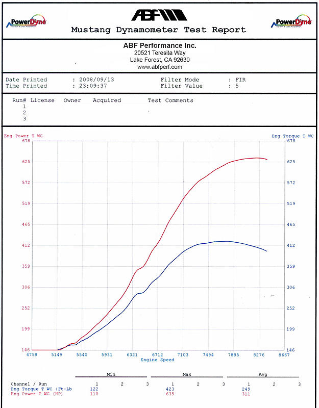

[SIZE=2]Why would Jan at RMW be talking to a customer about the ABF performance Mynes tuned ecu MINI USA drag car
I thought no one cared about drag MINI engines
Here's the dyno sheet for said engine
[/SIZE]

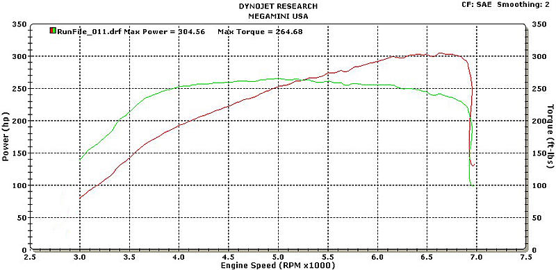

Here's some twincharge dyno sheets ...................

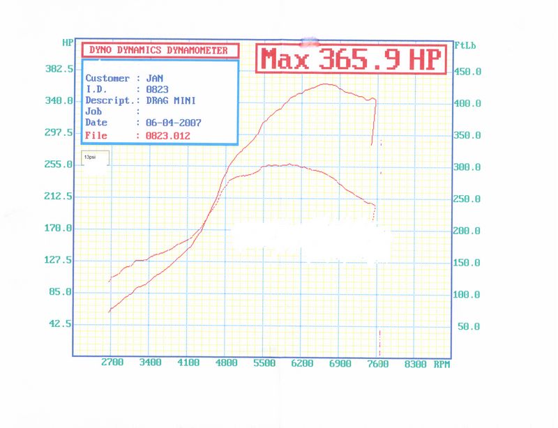

I wasn't and no one does care about drag racing Mini's... that's the point
For the RECORD......... I didn't need to use a GT35R to get that power either
here was the first dyno on the RMW turbo car.... NOTE^^^^^ 13 PSI................365whp /308tq
yes.... 13PSI................................. It took your turbo car 28psi just to get close to it.............. NO NITROUS EITHER
How soon you forget I was the first Mini owner to ever get to 300whp and 350whp WITHOUT NITROUS.........first and ONLY to 300whp with a supercharged car on pump gas and NO NITROUS......
btw..................STILL WAITING FOR YOUR TURBO CAR TO BEAT THE TIME AT SOW............................................... ........................

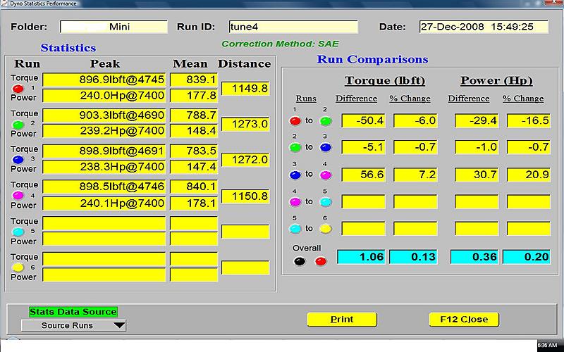

let's talk about the truth of turbo MINI cars.......... everyone is looking a peak numbers which doesn't tell the story at all...............
case in point
I will break this down for Paul and everyone else that gets confused with the charts............
even when you take the run that started at 900rpms......(try this at full load with a turbo and see what happens) the average hp was 148whp even though it ran another 1300 rpms of run time which affect the calculations Average torque was 788 ft lbs which converts to about 175-178 ft lbs AVERAGE even though it traveled 1300rpms more over the same time frame
so now lets compare a run on the supercharged car from 2400-7400 which was only 200 rpms less than the turbo cars run...............
average HP jumps to 178whp Big difference with that 1400rpms taken off........average tq was 840 converted to equal about 187 ft lbs ACROSS THE ENTIRE RANGE................................... as Paul has said numerous times......AREA UNDER THE CURVE IS BETTER THAN BIG HP
(thanks Paul )
Now let me help you with the dyno chart of the turbo... look no further than the stated AVERAGE HP IN THE LOWER RIGHT CORNER............(I wonder why this wasn't left on any of the other sheets posted around NAM?) I doubt you will see any more of these turbo cars posting those numbers.... it shows you how narrow the power band is and why the car is an on/off switch. When the TVS is complete I will post the final tally.... I can tell you already it's a slaughter of mythic proportions
so for 3 more psi of boost you get this........
average total power 134whp
average total torque 153wtq
as you can see........ big numbers don't equate to much unless you can keep it in a 2000 rpm band the whole time.........fun to drive around a track? Good luck Great to impress your friends.........definitely
Always.........make sure your tuner shows you that data, it's a telling story

Let's be honest here, as a street car, this is a non starter. Less than 146hp and 146lbft at 5000rpm? Let's be realistic.
And as for a race car, how many passes has it really made at 630hp+? I think it's dropped more valves than made successful passes.
Scheer's road race car is dropping valves at the high 300hp mark.
The black widow car car broke at the Eurotuner challenge running a 15 second 1/4 mi making 400hp+
I really wouldn't hang my hat on these three cars.
