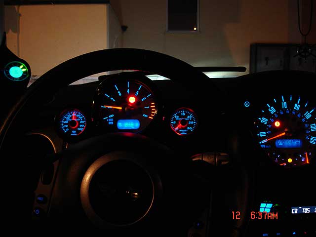

Aquire one generic Autometer A pillar pod. Carefully apply copious heat from a heat gun. Mold, bend, press, twist until you get a nice fit, then let cool completely. Night photo, but looks exactly like the duel pod in the previous posts.
Attached Thumbnails Anyone make a pillar mount boost/pressure guage?-dashlft.jpg
