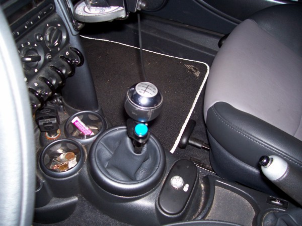

Just an up date.. I pulled the dry system and went WET!! I am making all my mods with OUT the benefit of a "Tuner" and after installing my ported HEAD I didn't like the A/F. The meth is working great, pulling 8 whp on the stock tune. However wanting to make sure I am safe... I just installed a wet system. I SWAG'd a 40 HP jetting, and will get some dyno and a/f time next week. I will dyno with the w/m system on and off!! ( the key being the A/F) also changing the mix on the meth to see to what advantage, also moving the Fuel jetting around to see the A/F difference. I figure this will help guys wanting to have fun, and not having a TUNE close or avaialble... yes?? SOOOoooooo.... Next week and either I will be freaking FAST.. or in pieces!! LOL
Just me..........................................
Thumper
Attached Thumbnails water/meth + N2O, thoughts?-nos-11-08.jpg   water/meth + N2O, thoughts?-nos-2.jpg
