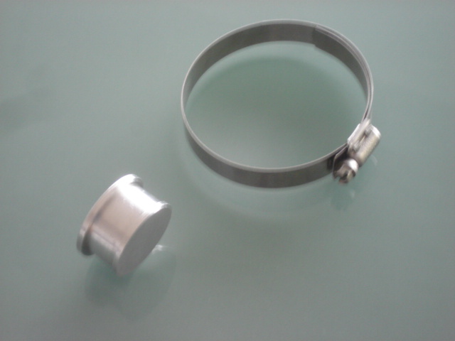

I´ve just finished installing my Alta CAI and have a few questions:
1. I don´t know if there is something I am missing, I only used three of the four hose clamps (size 48), does it come with an extra one?
2.I also have a cilinder that I don´t know what it´s for.
Here are some pics of the cilinder. Could anybody help me on this please.
Greetings from Mexico.

I could be wrong, so definitely don't take my words...I also have these leftover after my installation. I checked with my other friend who also installed Alta CAI on his MCS, same pieces remain.

That cylinder is to plug up the sound generator hole that you made by installing the intake, if you did indeed remove it. The clamp is to clamp it in and make sure it doesn't shoot out under boost.
If you removed the sound generator, and did NOT plug it up, I'm sure you would have noticed a significant loss of power! Take off the sound generator... it is a waste of space and time.

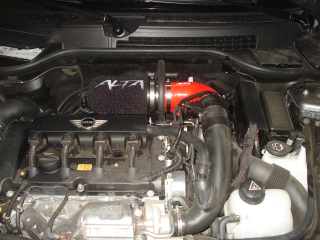

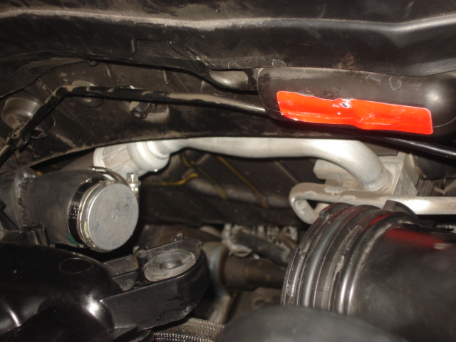

All right... So I finally removed the sound generator, and installed everything again. Here are some pics, just want to be sure I did it the right way.
Thanks everybody for helping me.

That's right! Although I can't see the actual cylinder plugged up, I'm assuming you did it right since the generator is removed! Awesome job.
there you go. thanks Noegel...
