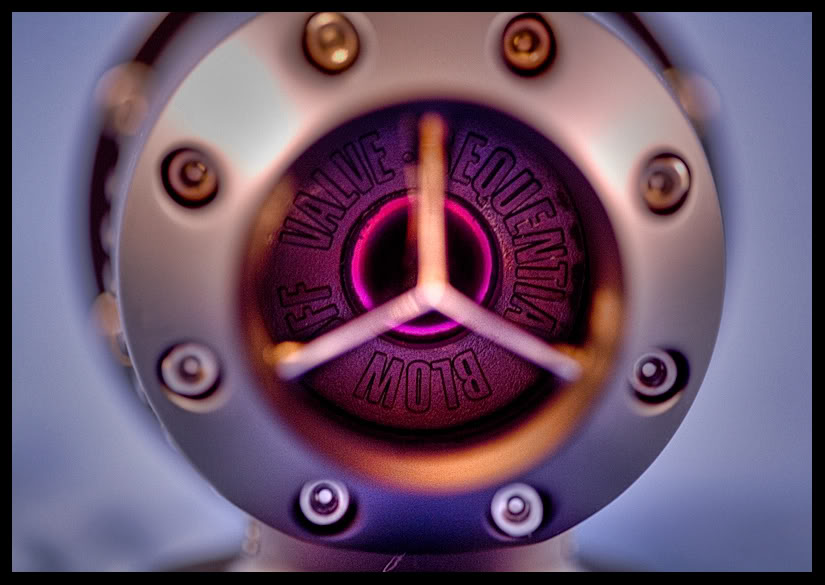

HKS Super SQV Blow-off Valve
I was lurking around and saw this Bov for the R56 models
and JSCspeed hook me up with one right away, in black, which is the only color I would gone with. I looked further and found a video of the valve at work... and one more here with tubes from exhaust depot which is just down the street from me so I will see if I can have it done soon..
Mean while the BoV will be a subject for pictures...It looks really nice.

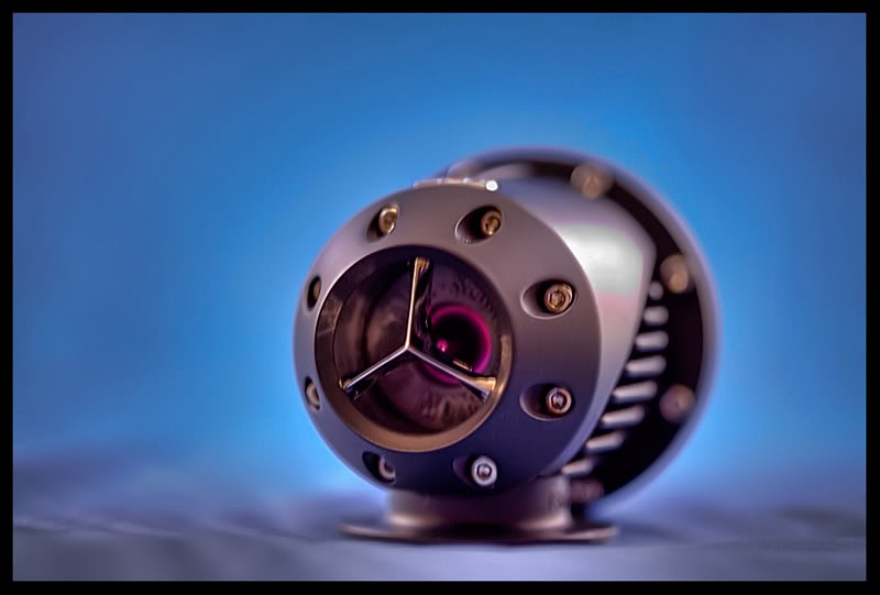

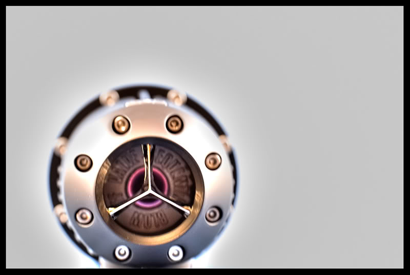

And a couple of my shoots, looks like a spaceship or something...

Take a good look at the BOV, if you notice every other screw is recessed in . If you remove the higher screws the housing will come off. You can then remove that plastic delta looking piece. This will change sound the ssq is known for and give you a more conservative sound.
Also if you notice the purple little piece, that valve comes off the seat under low boost conditions. Under heavy loads the black portion that says SSQ comes off the seat. So you have to valves there.
