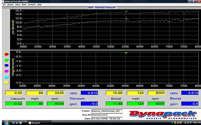

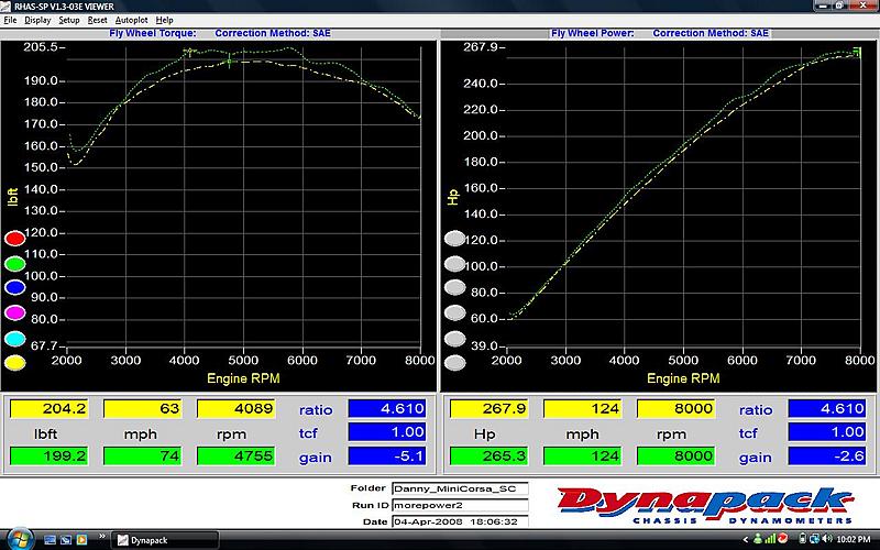

11.86 psi of boost........265whp
We have been playing with combinations and here are the results
RMW Head
RMW Cam
RMW 440cc injectors
RMW Race header/exhaust
RMW CP Pistons
RMW Laminova Water to Air intercooler
1.6L engine
JCW pulley
inlet temps at the end of the dyno run.........92deg F at 8k
for those of you that have scan gauges..... humor yourself and try this little exercise..... go from 0-90mph.........slam on the brakes and do it again and see what your intake temps are...... these were 107deg F at the end of the runs Once you do this you will appreciate the above
This was comparing this setup to a very similar setup running almost 4psi more of boost

Wow.... that would seem to suggest that flow and charge density trumps boost, eh?
You say the higher-boost setup was "very similar" - what specifically did it have?
Very interesting...

That sort of backs up what I have read before, that while spinning the SC faster there is a point where the heat build up degates the short lived gain... You da man Jan.

ahxactly. Volume + Velocity + Density is the key.

Now, is this something that could be improved on by adding, say a 15% or is this kit designed to keep boost low along with temps? The only thing high seems to be HP!

sure you could do that but then up go the inlet temps.......
this is more of a track application as a high rev'ing low IAT setup
look at the power band and IAT's....sick stuff
as for even more power.... it's on the way
