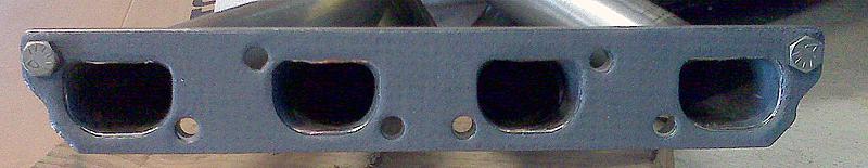

Guys:
As we tune and tweak for more performance the value of port matching is well known and significant. The question is, how far to take that before you reach the point of diminishing returns?
I have just received a new aftermarket header that does in fact have a 'D' shape at the head. However, upon closer inspection and alignment with the gasket there is definitely some room for improvement in the port matching. Please see the pic attached and the sharpie lines I have drawn on the flange by tracing the gasket holes. #3 is the worst, and sorry you can't really see the sharpie lines due to the flash.
Ok, just added a 2nd pic, this time without the flash, it is a little easier to see the Sharpie lines drawn.
1. Is there real value in tuning the header to better match the gasket/head?
2. A real concern would be the wall thickness of the header primaries, get too aggressive and I could have a problem by die grinding thru that wall thickness right at the flange.
Comments/Advice?
Attached Thumbnails Exhaust Port Matching-header_port_match.jpg   Exhaust Port Matching-header_port_2.jpg

Originally Posted by mini_racer
Guys:
As we tune and tweak for more performance that value of port matching is well known and significant. The question is, how far to take that before you reach the point of diminishing returns.
Comments/Advice?
Port matching is the way to go and this is the time to do it. It doesn't appear to be that much to remove but perhaps its the pic. I assume there is a weld on the back side that connects the tubes to the manifold plate so you should be able to grind safely. If your concerned return it !!

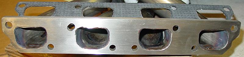

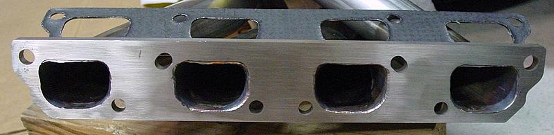

Header to Head comparisons
Given that the header inlet is much larger than the head exhaust port (see pics)........it would seem that some minor tuning on the header flanges would have no value. If anything is to be adjusted, it would be the head and it would be very significant.
Conclusion, I think I will leave well enough alone........

Originally Posted by carbonized
Maybe I'm wrong, but if my me memory serves me well, the header's ports should be slightly bigger than the head's ports. Something about slowing flow and maximizing volume (Bertouli effect). Most gasket port outlines are bigger than the head's one. Use the gasket to compare both head and header. Judging by the pics you should be fine.
I think the Bertouli effect has something to do with pasta? I believe you're looking for Bernoulli effect.
Old Jul 9, 2008 | 06:02 PM
mini_racer's Avatar
mini_racer
Posts: 756
From: Austin, TX
Carbo is correct, as shown in the pics with the header gasket on the header and then on the head. Except for the pasta fluid dynamics thing, of course
The exhaust flow steps from smaller(head) to larger (header), this will help to accelerate the gas flow out of the engine. (suck it out)
The header is RMW, and ready for installation as is, it is beautiful and ready to go with absolutely no additional tuning required.

The header is fine as is. My original misunderstanding of the flow step from head to header. See the previously attached pics.
Certainly the header at the flange does not have a perfect contour, but since it is already much larger than the head it does not matter.
