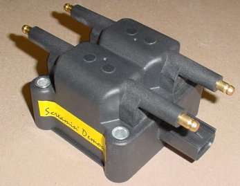

How about screamin deamon???? is it a better option than MSD??:confused:
Old Jun 3, 2008 | 08:28 AM
tennis_man's Avatar
tennis_man
Joined: Jan 2005
Posts: 180
From: Orange County, CA
I have been using a Screamin Demon Coil Pack the past four years with no problems. The stock coil puts outs 36,000 volts but the Screamin Demon is supposed to put out 40,000 volts.
I've never used either. Based on the testing i've seen they don't make any more horsepower. I fail to see the point in upgrading them, unless it's purely for aesthetic purposes.

do you know if you need new bolts or mods to install the sd coil?..i saw on alta they send you special bolts for the msd coil but i havent seen much on the sd?
