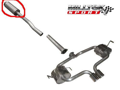

I have a full milltek exhaust, sound great but one thing. Just after the cat there is a cannester that when i shake by hand i can hear something rattling i dont know what it is. Is it a resinator???? if it is how do you fix the problem anyone know???

cut it out.

You mean like this?
You might want to try to get a replacement under warranty from Milltek. If not, just weld a pipe in there - that's what I did. I will weld in a Hushpower resonator when I get the chance, though. With a header and without the resonator this thing is LOUD.

could you post a picture of looking into the thing?

My camera is out of batteries, I'll post the inside in the afternoon. However, there's really not much to see other than the baffle. What rattles is the fiberglass between the outer shell and the baffle, which melted into beads from the heat. If I cut this thing up i'll put up a picture, but I don't plan on cutting it up anytime soon.

I've blown out both cats and resonators with the milltek. It's a fairly well-known issue.

Outmotoring replaced them - again, it's a fairly common problem with both the header and the resonator.

i had a friend that had same problem. He took the exhaust out and removed the heat sheild around the cat and resontor, Fixed the problem
