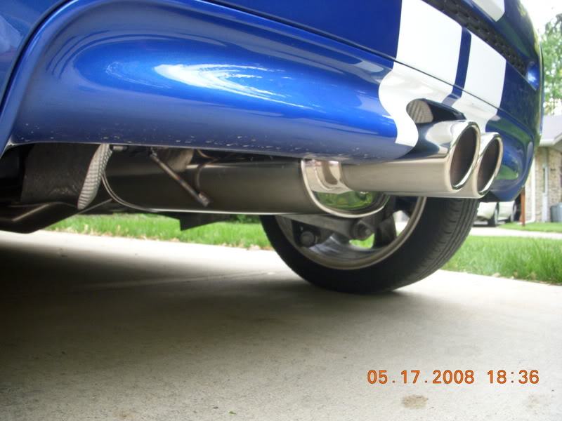

would it be possible to get some more photos & info on the WMW Exhaust?
I'm looking at getting the WMW in black. but looking at the photos the rear box & tips look very different from the standard polish finish.
to be honest i like the look of the black much more. the tips even look more substantial. what size are the tips....more photos? I'd like to see them straight on and even mounted to the car to see how it fits the cutout.
thanks.
here's a pic of the 2 side by side.
here's a pic of the 2 overlayed.
thanks.
