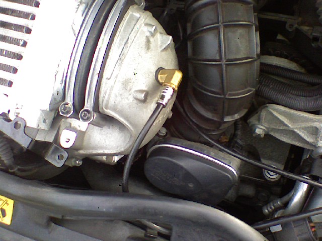

With my setup, i could drive in the summer and the horn that you see will stay pretty cold, but everything before that is pretty damn hot.

how much did it cost you to have such a system?

they range from 300 to 800 dollars depending on the sophistication. You can install the sprayer before or after IC or both. What you have to appreciate is that you are also cooling the cylinders w/ the water and if you have meth added you boosting your octane so it can increase HP as well.
makers are snow performance, alta, coolingmist.
check it and read up for this might be ideal for you living in hot climate.
