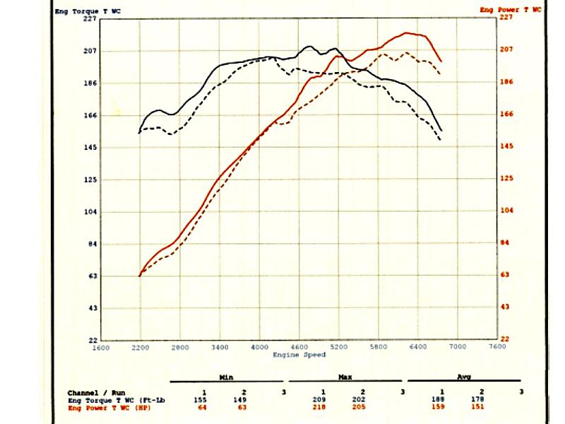

I just got the RMW tune last evening, and the results exceeded all expectations, even in view of the tremendous reports earlier in this thread!!
So here's the story. I was lucky to get on the dyno within about 10 min of arriving at Helix, but as a result the engine was still hot from the drive up. First pull netted a peak 186 whp/~190 ft-lb, which Jan thought was strong for the mods. Luckily, Jan knows the importance of getting a good baseline before making changes, so he let the fans cool the engine before the 2nd baseline: 205whp/202 ft-lb
. This is only with the 19%, JCW 380s, HAI, OBX header - Skunk-2 catback (like the Inivdia). STOCK tune. Even though my car is an '05, it was a 12/04 build and the software loaded at the factory was actually '04 software (Jan could tell).
Even with these results, the engine operation was far from optimal. AFR got very lean, 13-14, in a couple places. Specifically, just as the BPV closed around 2800rpm the AFR jumped up until the EMS got the info from the O2 sensor to add fuel. And, in the 4500+ range it leaned out as well. I was a bit surprised to see this, because I figured with the 380s and no tune the engine would tend to be on the rich side. I am very very glad I went to the 380s when I switched from a 15% to 19%, because another guy there had burned a valve running a 16/2 combo with 330s and Unichip. Another sign of the sub-optimal engine tune was the big puffs of black smoke that seemed to coincide with the knock sensor kicking in.
Jan methodically worked out the problems, and the end result is below: 218whp/209 ft-lb.
AFRs totally safe, very little black smoke. Eric took it out for a spin, and the sound was freakin' awesome to hear echoing back from a few blocks away. Eric comes back with a grin on his face saying "this car is sick...". High praise, I think.
The dyno plot, however, really doesn't tell the story of how incredibly much better this car drives. From a standstill, this car now literally picks up and flies, almost effortlessly. Not that I ever had real problems with surging/bogging/flat spot, but now it just blows past that problematic 2500-3000 range without blinking an eye. Don't even get me started talking about the upper rpm range -- this thing revs so freely and eagerly now that controlling my speed on public roads takes enormous willpower.
There were some theories advanced on why the car pulled so strong. One is the HAI is a superior intake, at least on the dyno. Possibly, the guys in Oxfordshire or wherever Minis are built won their soccer match the nite before. Another thought is that maybe, just maybe, all those people who post over and over on NAM that anything greater than a 15% pulley makes hot air and no more power are ... how can I put this .... mis-informed?

Deal. Anyone else want to play on the Helix dyno in July? If my tune is a mess then, I'll pay the dyno time. If its running just as good as it is now, you pay the dyno time. Thoughts?
very nice numbers!! I'm hoping to get my torque up to that range....even if we don't make more than the previous 233hp, I'm ok with that if the curve shifts to the left a bit as well. given the minimal time we had last week and the dyno being more useful for tuning this week, we'll see how it goes.
Your TQ is amazing giving the mods on your. One thing I want to point out is how different each car's power is. There has been allot of debate over the "stock" power output from the factory. This huge tuning party shows once again that even though we all have the same motor from the factory we don't all have the same power.
Some are stronger than others. Some a lot stronger!
