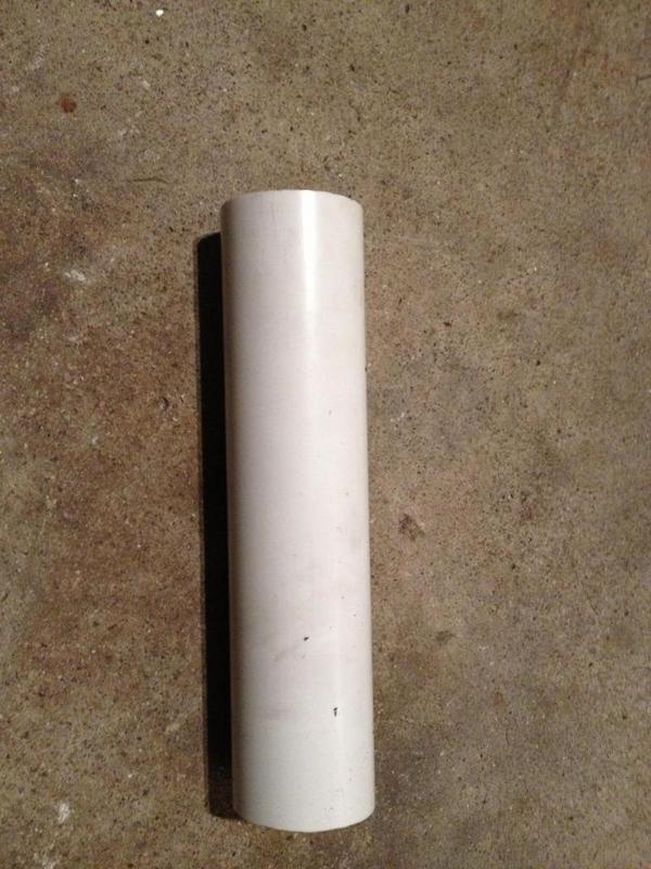

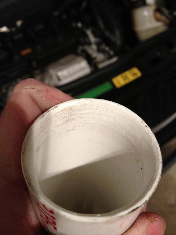

so i spent 30 minutes and $3. coming from a honda kid that likes the engine bay to look less stock, removing of anything is a plus for me! here is what i did...
NOTE... this upgrade does not show any sign of power increase and minimal sound enhancement. to achieve such results, as listed prior, intercooler, intake, and exhaust systems would need to be upgraded.
  1. go to "Home Depot" and head to the plumbing section.
  2. find the precut PVC 1-1/4". they are all cut to 24". i used the saw they have available to make additional cuts to cut it into 3, 8" sections.
  3. head to checkout, the part is listed for $2.70 and you only pay for one.
  4. after removal, very simple if you have a 7mm, 8mm, T20 sockets, 6"< extension, flex tip, drill, and floor jack.
  5. raise car on driver side. remove bolt from radiator overflow container and carefully position it out of the way. loosen hose clamp at turbo. use T20, flex tip, and extension to remove mounting bolt.
  6. pull from hose the top to get it out of the engine bay. then loosen hose clamp below muffler delete.
  7. for best results, tapper both ends of the pipe with a dremmel tool. be sure to remove all debri before installing
  8. attach upper tube to PVC, attach upper tube to turbo, secure radiator overflow container, attach pvc to lower tube, lower car. DONE!!!
this is what my pipe looked like
this is the tapper i did to promote better airflow
Attached Thumbnails Has anyone installed intercooler muffler delete?-mufdel001_zps821cd8e6.jpg   Has anyone installed intercooler muffler delete?-mufdel003_zpsa6239cf4.jpg
