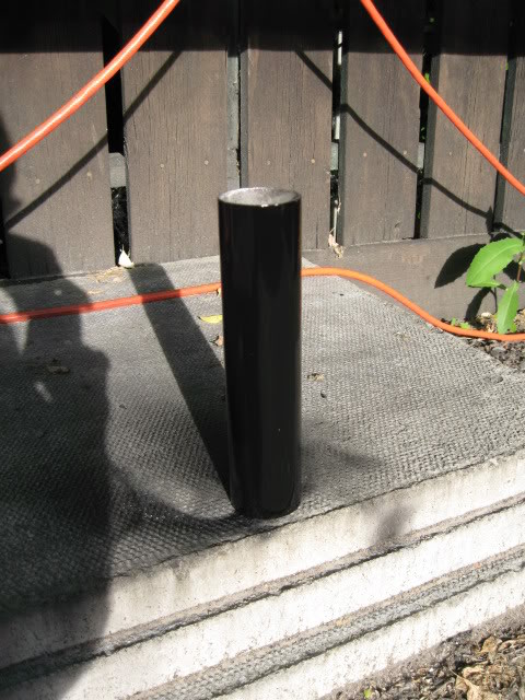

so, I just finished making my own and it's now installed. It's supper time now, but I will head out for my nightly cruise and let you know what I think. I took some photos, and I will post those as well.
Quickly to say, it cost me $5.00 to make my own and about 1 hour to do. Pretty damn easy.

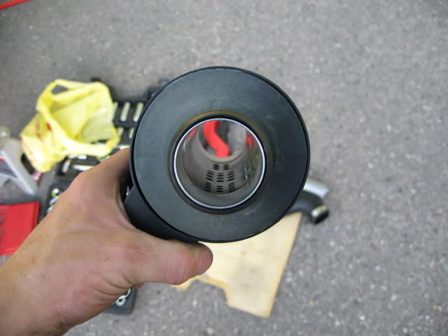

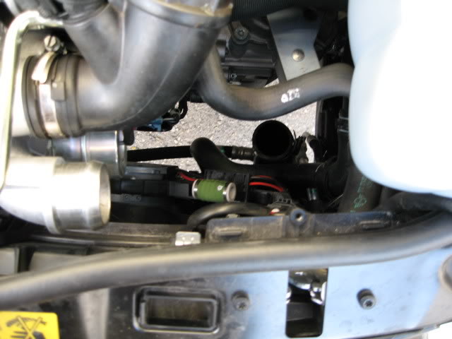

Now after my 1st hard long run, I pulled over and removed the rad fluid container to see how hot my tube was. Well I tell ya, you cant hold your hand on it for very long!! I wish I had a "laser" temperature gauge for some real temp readings.
So this is what I did, jacked up the drivers side, 7mm socket, loosened 3 clamps. turbo out, muffler in and muffler out. Grab a torx T25 and remove the muffler bolt (it's hard to get at). Remove the rad fluid container, 8mm socket, and just move it out of the way. Then pry/twist the hose off the turbo, then off the mufflers.
2" OD galvenized pipe @ 8" long. I flared the ends out a bit for better air flow and clamping power. Painted it black, and reinstalled everything. I dont see why you would have to reclamp the pipe to the car, it barely moved.
My photos dont show the pipe with the flared tips, I did that after (dont ask, hehe)
There you go.
Scott.

Ok, so after another great night of driving, here are my conclusions.
My MCS sounds much better, even at idiling, she has a deeper tone.
I really think there is more power coming out of the engine.
I was cruising around for about 30 minutes, when I realized that the sport button was OFF!!! It felt like it was on.
So, my tip, buy one, make one, and try it out. I am very happy with this mod. Plus I even feel now, that the Mini Madness one is worth the money.
Scott.
