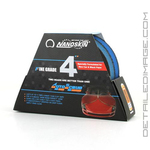

I've used Speed Shine as a lubricant in the past, I have a new system now!!
Nanoskin Autoscrub, it's clay without the clay!!
