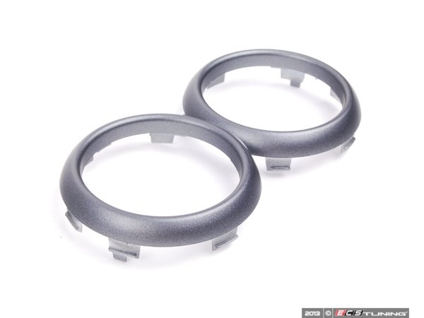

Are you talking about first generation MINIs ? R50 R52 R53 or newer second Gen R56 R55 R57 +
For example:
First Gen R50 R52 R53 anthracite: Cup holder.
http://www.ecstuning.com/Search/51167039238/
There was chrome , light silver, Gun metal ( for some trim ), and anthracite.
On R56 +
There was chrome, silver, and black. Cup holder trim example.
http://www.ecstuning.com/Search/51162756165/
Let me know what you are looking for we are here to help.

The clips are at certain points, it does not matter, you have to find those points, get closest to them and slowly pry up. You can work it out form the easiest point they lift out. You have an R56 correct?
#18 https://www.realoem.com/bmw/enUS/sho...diagId=51_6177
The main piece has that peg that needs to come out and the main pieces is bonded to that inner trim.
https://www.ecstuning.com/b-genuine-...t/51412753337/
