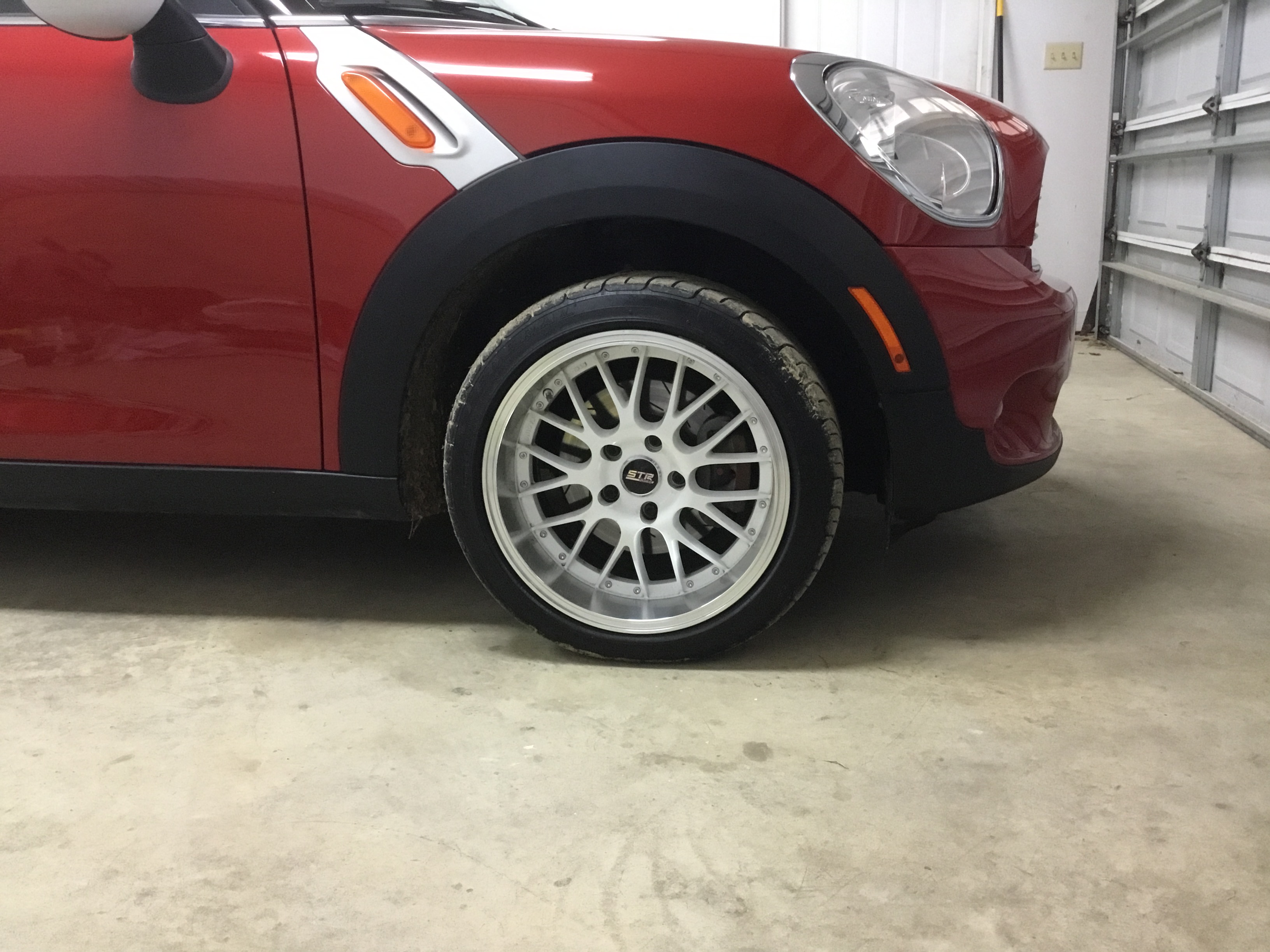

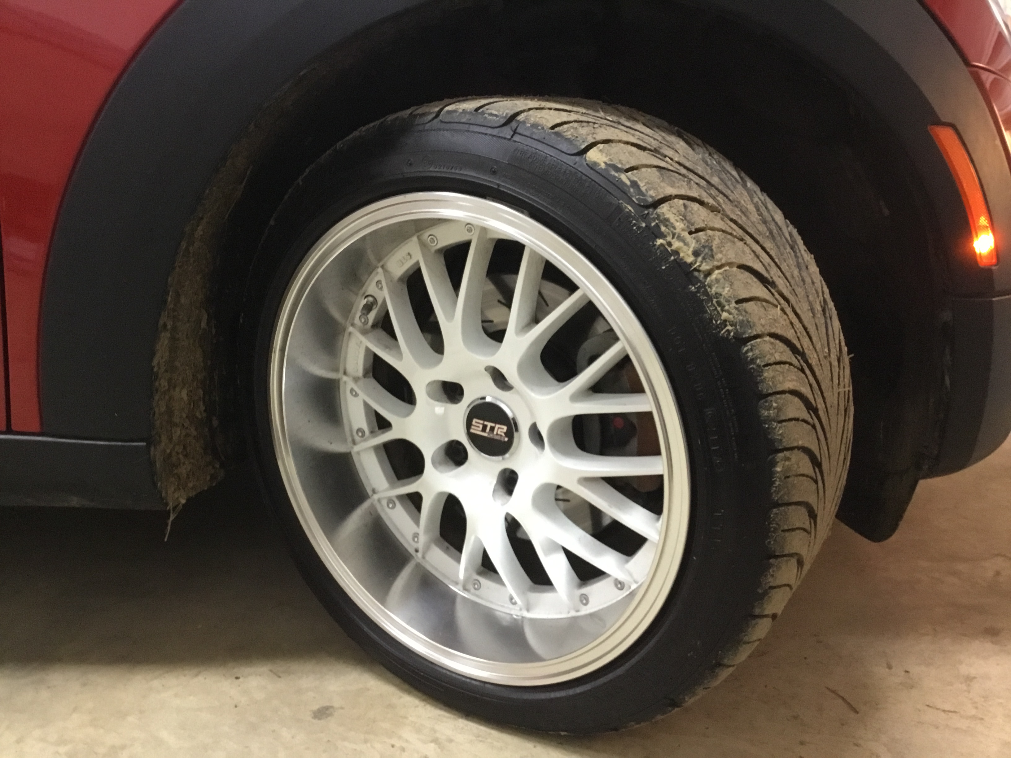

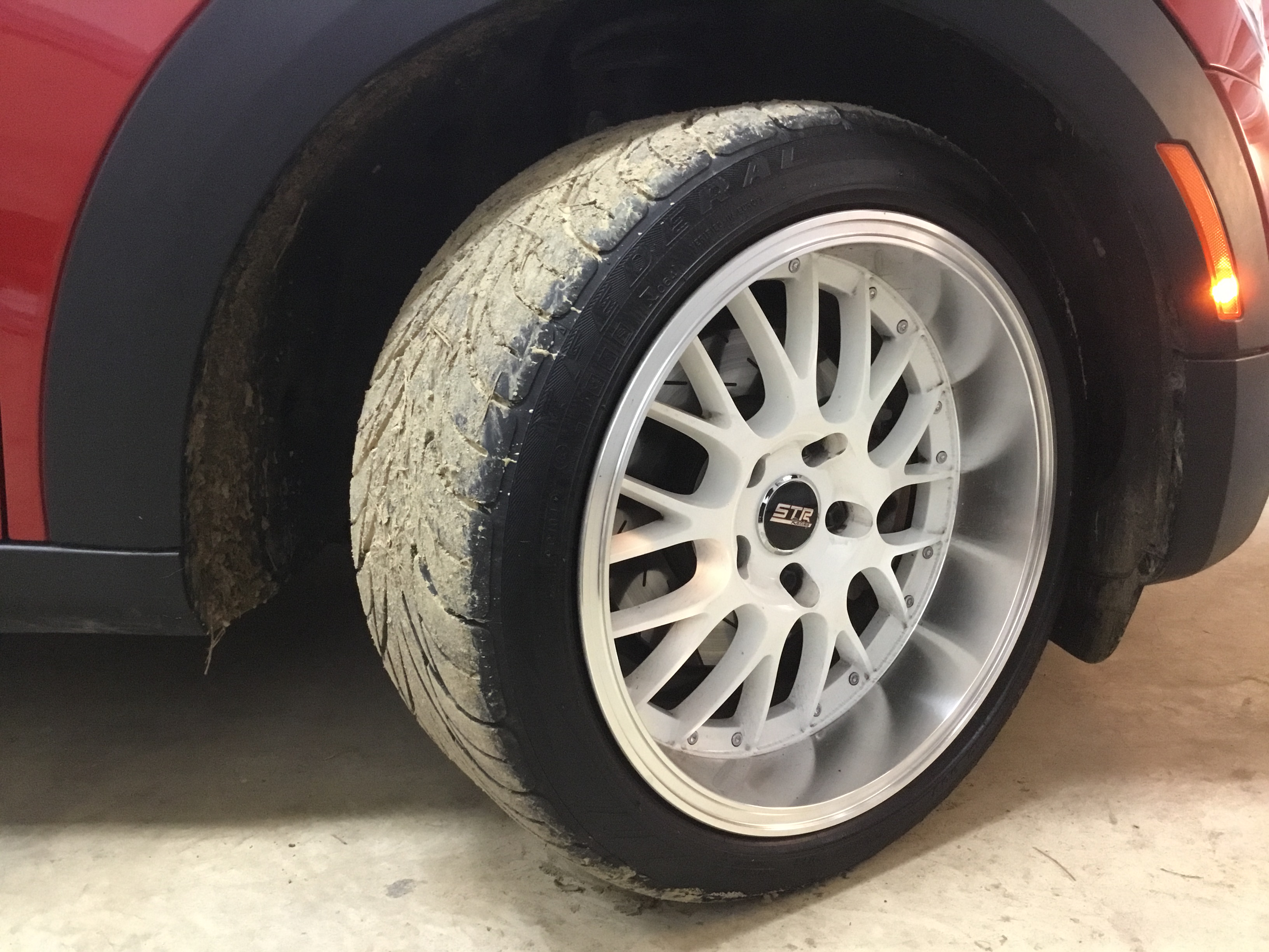

We went pretty aggressive on my wife’s 16 c.m. 17x9+20mm, 235/40r17. Here are pics, let me know if you have any questions.
Attached Thumbnails Wider tires-062b7acf-8a24-45e2-a38a-47586f6f9d12.jpeg   Wider tires-e6d69637-7860-454c-a9b2-7782e4c981fd.jpeg   Wider tires-60a10ed4-8fb5-4781-8887-2f8d11cbc2d4.jpeg   Wider tires-65629271-bdc7-4b6d-ad93-bc1e05b29446.jpeg   Wider tires-c2ff2347-5c86-4664-ae13-00bf204d7fab.jpeg

Very nice. Looks good! I do have a few questions... About to put my 17x8.5 wheels on this month.
How much camber are you running in the front? And rear?
Did you use any wheel spacers?
Any rubbing at full turn? Or when hitting bumps?

No change from stock in camber on front or rear. No spacers.
No rubbing at full lock. The two pics that the wheel is turned, is full lock both directions.I could fit 45 series tire, but with less than an inch of clearance at full lock with the 40 series tire, it’s to close for my comfort. At full lock and a large bump, a 45 series would rub...nut much just a kiss. But if it rubs, it does not truely fit.

Yeah no worries on rubbing there. Those are nearly an inch-and-a-half shorter than a stock wheel/tire. Not to mention your speedo likely being off 4-5 mph, plus adding about 4 extra miles to the ODO for every 60 you drive.
