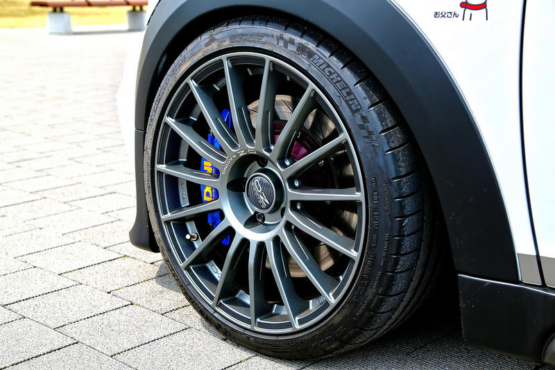

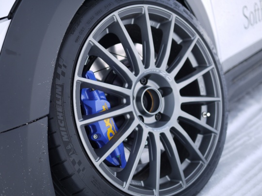

What Wheels Are These???
Does anybody know which wheels these are? Size, Offset? They look like 19" but I cant tell.

probably OZ Superturismo Dakar:
http://www.tirerack.com/upgrade_gara...raphite+Silver
not sure about size and offset

They are OZ Superturismo LM wheels in 19" probably 8" wide (but don't quote me on width). Not sure about offset but it looks like +40.
The tires are Michelin Pilot Super Sports in 225/40/19, I believe.

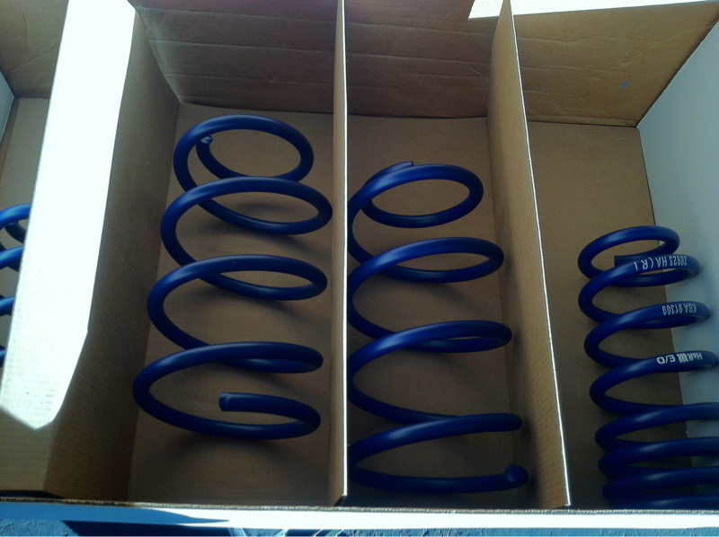

Very good point. I am putting on my HR Springs tomorrow and am waiting to get that in place so I can put different wheels on to see how it actually looks.
Can you post a photo of the springs before you put them on?

That said, that wheel looks to me to be about 20-23et not even close to 40, and that tire is stretched beyond even Michelin's safety standards. Additionally there is potential damage to be sustained running that set up or modifications to both liner and trim would be requred to run that low for street application. Hence the warning from Tire Rack............

Those wheels are 19x8.5, 5x120 and have a 40mm offset. The tires are Michelin Pilot Sports, size 225/40/19, as Hujan said. That's the same size 19" tire you will find on the OE upgraded 19" wheels that Mini fits on this car. It's definitely the right sized tire. The wheel/tire combo obviously will fit, considering it's on a Countryman you see in the pic that the OP posted. It is, however, a little bit of an aggressive setup, mostly because it's an 8.5" wide wheel and a low'ish 40mm offset. Which is why it's not recommended by Tire Rack. BUT it doesn't mean it won't fit, because it will fit with some modification. I also have the same exact tires on my car, but my wheels have a 45mm offset and are 19x8.
FWIW, you can also get the OZ Superturismo LM wheels in 18x7.5 with a 47mm offset, which will fit perfectly, as well as 18x8 with a 40mm offset, which will fit with some tweaking.
Original size image, look on the lower part of the image, you'll see the tire size is 225/40/19. You can also see etched in one of the spokes it says "8.5 J X" but the rest of it is blocked by the spoke, but it says "8.5 J X 19"

Here a quick pic
