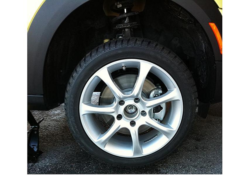

Hi folks
I installed some BMW e90 wheels on my Countryman ALL4s
They fit just fine - same bolt pattern and center bore - I did not leave them on though as I think the stock MINI bolts were a bit short - The BMW wheels had a different offset so the hub was thicker - I will need to call the Rack to figure out what I might need. Also of note the hub lip/bore did not extend very far into the wheel , though I am guessing this will be ok as the load is taken by bolts
It seemed to clear everything ok but did not road test
Note the wheels I put on were 17" x 7.5
Wheels are marked as ET 32 which I think is the offset
BTW the turbo fans with Run Flats are very lardy - no surprise but they felt over 10lbs per wheel heavier than the ASA. I will weigh them when I reinstall the winter boots once i track down some longer bolts
My next job is to pull the bloody pads out - I forgot that these buggers shed so much - I am hoping to find EBC greens as they worked great on my MCS
Attached Thumbnails Winter Tires-asa-wheels-close-up-hub.jpg   Winter Tires-asa-bmw-on-cm.jpg
