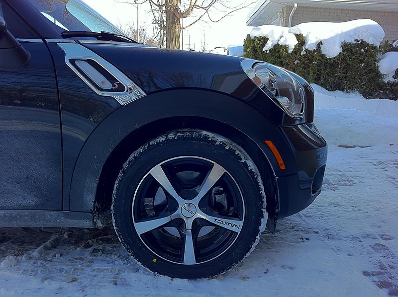

Touren TR9 Rims Blizzak WS70 215/50/17 winter tires
He just got this setup yesterday. I believe the suggested tire size is 205/55/17 but these fit fine. Though it might be nice to have a bit more sidewall there is a lot less selection in that tire size.
So far the Blizzaks are great on the snow but get squirmy at high speeds on dry pavement. Apparently after 300 miles they get better and at 2000 they settle in nicely according to a review I read.
Offset on this rim is 40mm, 72.6 is the bore and bolt pattern is 5 120.
Lots of clearance with this rim for the breaks on the "S". Hope this helps everyone out if they need winters. Feel free to pre order this set up before picking a Countryman. Especially if you are getting the 18" sports tire package. Those are like driving on greased hockey pucks! Very dangerous.

Niiiiiiiiiiiice!

You should post this pic in the Countryman pic thread in the general area
