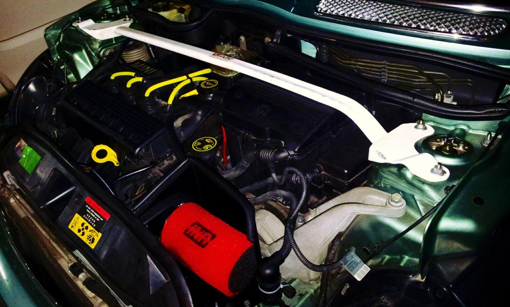

finally the installation is completed. it consumed me 2 hours but its fast after cut the item 3 ...
the acceleration is a bit faster and the rpm rise quicker
and the fuel consumption also become higher too, very obviously :(
Love the sound very much, especially above 4k rpm... the sound is amazing. my previous K&N drop in cannot compare with that.

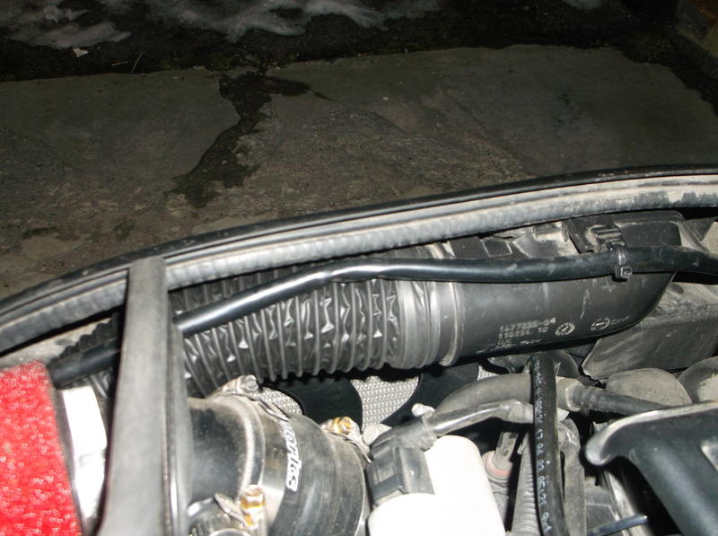

Installed one of these this last week and ran into the same trouble - just ended up cutting it off like everyone else here. The fact that there are A/C lines nearby makes it pretty nerve-wracking whether you're prying or sawing.
The clothe tubing that runs from the radiator support to the airbox on mine was disintegrating and I found a great and cheaper alternate to replacing with the OEM hose.
NAPA 8131509 is a flexible, plastic hose with the correct I.D. It's more flexible too, which should allow me to be angle the airflow right at the filter/housing. $3/foot (my store would only let me buy a minimum of two feet even though you only need one since they had to special order it in). Will try putting it in tonight...
The 2 1/4" ID stuff ended up being a pretty tight fit on the plastic piece in the center of the radiator support, but it did go on snugly with some prying. A definite improvement over the disintegrating stock one. I'll try to snap a picture of it tomorrow.
Lesson is - check that cotton hose on your MINI! It might be disentegrating like mine was and releasing constant cotton dust into your air box!
Also, I have a little over a foot of the hose left - if anyone wants it for $3 + shipping, just PM me.
