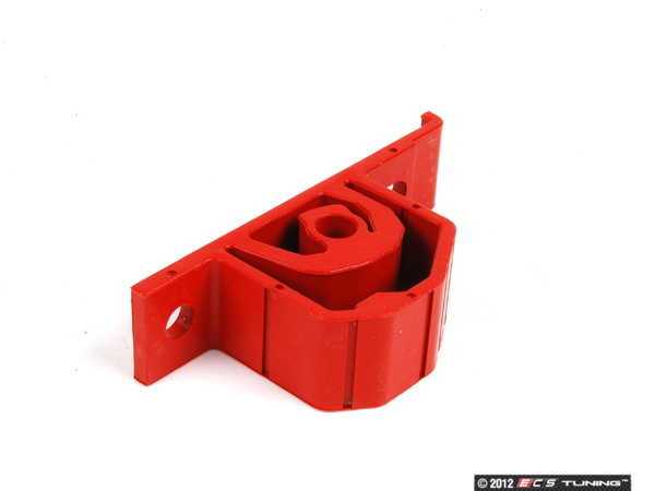

Eleo,
Did the center rubber drop on the bracket, where the exhaust hanger slides into?
Here is a picture of the part you were talking about.
http://www.ecstuning.com/Search/18207521427/ES39944/

Yeah the narrow center hole where the exhaust hanger hooks into looks like it's missing all together. I don't even really know what's holding everything in place. No idea if it was already like that, broke simply from being handled or was abused by the installer... But with the muffler hanger tangent with the chassis of the car, that probably makes up for a lot of the vibration.
Seeing one is broken and that the car is 9 years old, I'll probably replace both.
I still need to jack up the car to see if there's anything else that's on its way out, e.g. 18100392258 or 51717037919. I hope I don't find anything alarming about the installation, and if I find something welded I'm going to throw a fit. Although the shop was recommended by a colleague, I don't have very much faith in these guys right now. Since I have to go back in behind them and clean up, at this point I basically paid $100 for them to cut off the old exhaust.

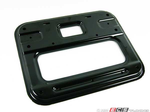

http://www.ecstuning.com/Search/18100392258/ #8 in diagram one on each side.
They mount to the center exhaust carrier. #6 in diagram
http://www.ecstuning.com/Search/51717037919/ES128663/
You can inspect them by looking above the plate. Replace them it they look torn or sagging.
