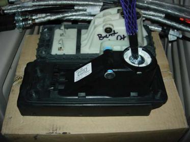

I don´t know what is the condition A and condition B reinforcements or black smooth box. Can you post a pic please?. I´m very curious about it.
I didn´t need to modify anything on the electrical wires. I suppose dou you talk about the rear light switch. In european cars is just to plug&play with all of necessary parts.
Here is a picture of the white condition A and black condition B boxes.
Okay, I was not sure about the wiring cause I saw somewhere that someone did some wiring modify.

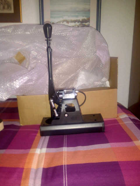

Ok, I know what is. I don´t know which we used in the Cooper, but in the One we put a racing item as you will see attached. Very quick and totally accurate gear changes
Oh wow, I never see that before. Just curious if there is a link for this?

Of course. Here it is: http://www.cae-racing.com/shifter_mini.htm

Thanks, that shifter looks smooth and interesting. I am gotta skip that and dont want to spend that much money.
Thanks for the help.
