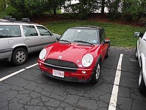

I thought I would post the progress of the rally Mini build as I slowly put this car into rally mode. Don't expect a mega bucks build as I have a very limited budget, also don't expect to see many Mini parts going on the car! The donor car is a 2004 base Mini Cooper which was an ex rental car so the interior was not great but as a rally car this is not important plus it was cheap. I got the car off Ebay with the seller saying the car ran ok apart from a rough idle. After investigation I found #2 had a stripped thread for the spark plug. Worse still was in had already had an insert fitted so I used a big sert kit to fix the problem but to my surprise the engine still ran rough. So I pulled off the cam cover and removed the rockers. Then hooked up the air line to #2 cylinder and put some pressure in. Checking the intake and tail pipe revealed the tail pipe had an healthy blast of air coming out. Then I made a tool to remove the valve springs with the head on so I could push the valves down to see any damage. One exhaust valve had a burnt seat so game over. Next I'm going to get a Cooper S head as the exhaust valves are better.

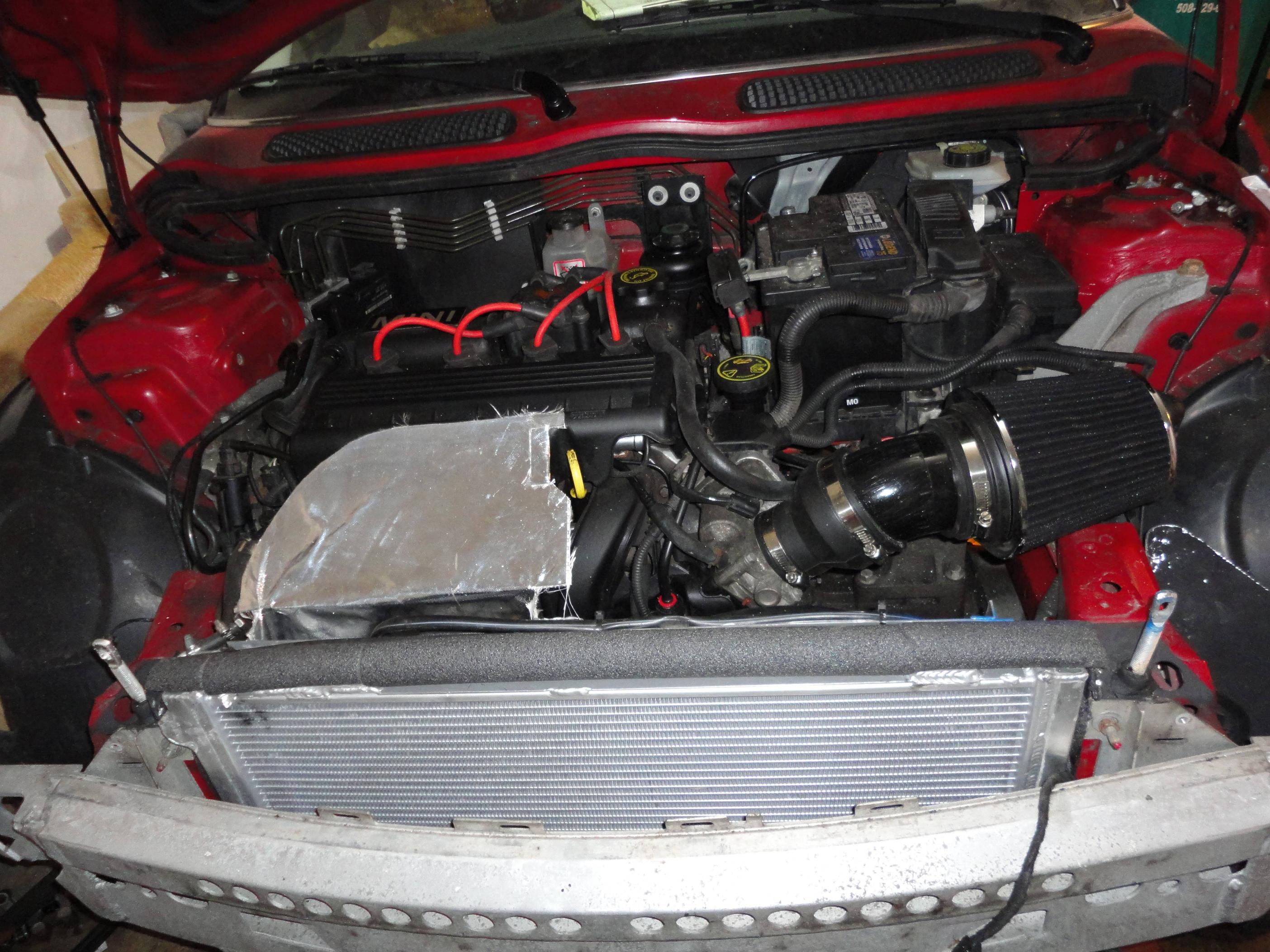

Kicked off the build today and hit problems. As reliability wins rallies I'm replacing the water pump with a new one but the bolts were scary stuck until I slowly got them out. Then I found the metal coolant pipe was really coroded, also the radiator fan sounded a bit suppect so I'm replacing that too. I got the "S" cylinder head on but not connected everything up yet.
The original raditor will be toast in no time being plastic ends so I've opted for a 4 core rally aluminum Subaru WRX radiator which will fit after some modification. I plan to junk the plastic surround and make the bumper a one piece off for easy access. Also I found a belt to run the alternator/water pump without the need for the dummy A/C pulley.
That was some week! finally got the Subaru WRX radiator in, a 165F thermostat, Way motor mounts, Lowes CAI hahaha, Computer servo fan for the power steering pump, custom mesh grille plus putting the head back on. I hope tomorrow to have the car running.

Regarding the radiator. I have a high regard for Subaru parts as they seem to be strong and built well.( Some Subaru's see 300,000 miles without issues) The competion parts (STI) are even better. So having worked on Subaru's I knew the inlet and outlet were in the correct position to fit the Mini. The length is about 30" so just fits between the chassis rails. It took me about 8 hours to make a frame the support the 95 WRX aluminum 4 core radiator. I didn't use the plastic surround but maybe it's posible to use it? Also I made some brackets to support the wheel arch liners and used Dzus fasteners to hold on the front bumper. The bottom hose was a auto store universal hose and the top I cut up the original botom hose. The good thing is the WRX radiator comes with a small pipe extension near the top outlet which I used to bleed the system and then blocked it off. The original fan I cut up and made brackets to fit the radiator. I also made some heat shields to duct the heat away from the intake. I wanted the radiator a little forward to give more clearance so I cut the inner hood metal away to gain clearance and save some weight.The CAI is a 2" to 3" Lowes rubber toilet pipe connected to a PVC pipe($10 for both) then to the cone air filter. Works and sounds great! The 165F comes from a 2001 V8 Ford Explorer. The size is 54mm so there is enough metal to copy the Mini. For the skid plate I made a frame that goes under the radiator and bolts up to the subframe. I have this early photo of the radiator in and part finished heat shield and Lowes racing intake!
The front grill I'm going to re-visit as I had to blind rivet it on quick for the state test. I like the look but not the rivets . Also the pipe foam on the rad will be replaced with better.
Overall the car drives and handles well, not as fast as the Swift but I'll be working on that when the car reaches Costa Rica.

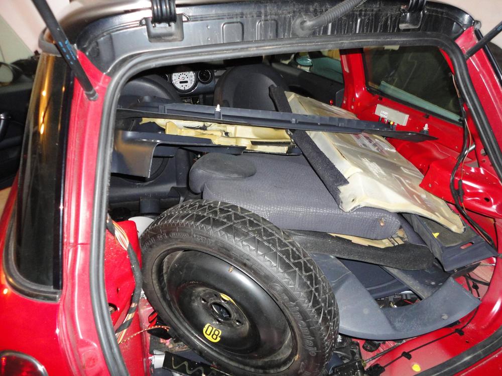

No turning back now! Got a few hours yesterdy to pull out the interior
Heat shield behind radiator. The new radiator keeps the temp just below normal while driving which were it needs to be for rallying.
