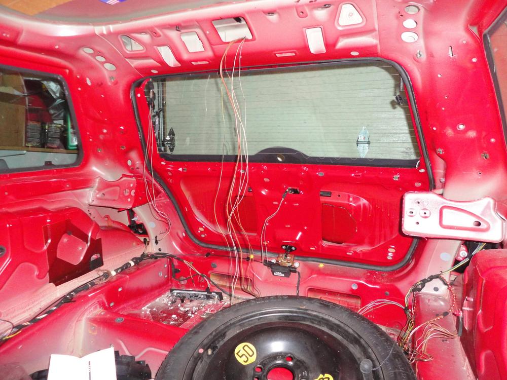

Yesterday was an all out attack on removing the extra wiring I don't need, such as rear wiper/window heater, airbags, speakers and door mirror. This is best done with scissors and gloves as the black mess thet wrap around the wires is very sticky and messy. I managed to remove all the wires up to the bulk head, then I cut and taped them off until I get the car to Costa Rica when I will remove the dash and heater to remove those wires I can't get at. Everything else is about done apart from some brackets to drill out. Next will be the seats and harness.

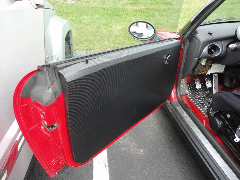

[SIZE=3][FONT=Calibri]Regarding the door bars: they are spot welded at each end(they were in the Suzuki) so I drilled out the welds and cut the bar in the middle, then pulled out the bar. I only did this because I have a X in the cage for the door opening.[/FONT][/SIZE]

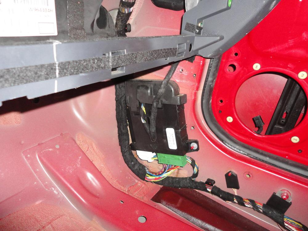

[SIZE=3][FONT=Calibri]What is this control box on the passenger side?[/FONT][/SIZE]

The weekends work went very well with the seat in, door panel made(I need the handle to close the door) pedals and D1 throttle control fitted.

The black box in the picture is the BCM (Body Controll Modual) Prety much EVERYTHING electronic (Minus Engine controll functions) is ran through that computer in one way or another. All your gauges, lights, safty equipment, EVERYTHING. Its not really something that can be easily removed.
I llike your idea of door pannels, if i ever decide to add some "Door bars" to my bolt in roll bar I might borrow your idea a little.
