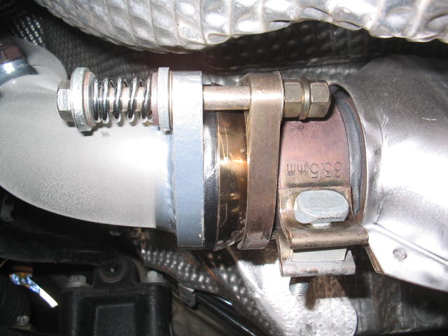

I duplicated what someone else on NAM did using Magnaflow part number 91036. Many online places sell it. There is a great thread somewhere on NAM. There is a bit of fabrication and cutting to get the cat to fit, but nothing horrible. Here are some photos from various threads on NAM that I followed.
