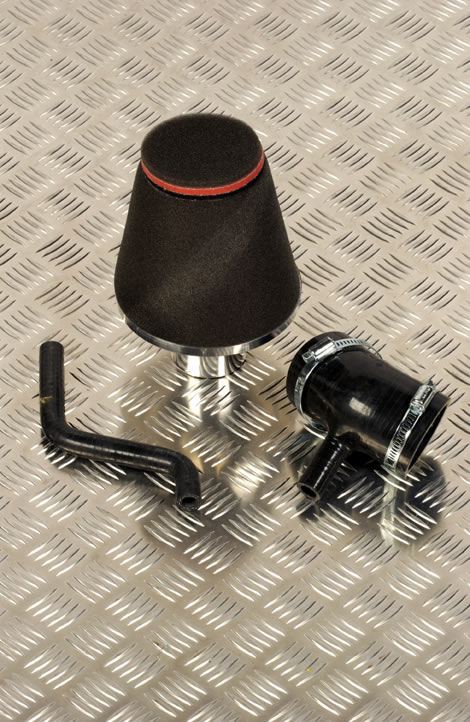

Pictures of the JCM parts
It took a while, but I finally located some pictures of the John Cooper Motorsports parts that were fitted to the Clubsport cars;
The first image shows the entire kit. Part#JCM550. This is everything fitted to a Cooper including the Safety Devices rollbar, battery isolater kit, Powerflex poly bushings, 7mm wheel spacers, Bilstein coilovers, etc. The flat aluminum plates with the brake parts on top of them are the left & right gas tank isolators that were fitted under the car.
Cooper Header + Exhaust #JCM507 The header design was the same for both the MCS & the Coopers, but I cannot confirm if they used different primary sizes. There was a note on the JCM website to be sure to specify if you were ordering for a Cooper or an MCS because the Cooper used a 2.25" outlet & the MCS had a 2.5"ID.
JCM intake #JCM510 made by Pipercross UK. The foam intake filter had a spun aluminum base shaped like a velocity stack & originally had 'WORKS' in red letters diagonally on the side. In order to get more air to these, the practice was to drill holes in the top of the plastic radiator surround. You can still get a very similar filter from Pipercross, Check out the universal racing filters section of the Pipercross UK website
It takes some hunting, but you can find some good paddock views of these parts in use on the MINI Challenge website. look for the link to the 2004 thru 2006 challenge archives!
