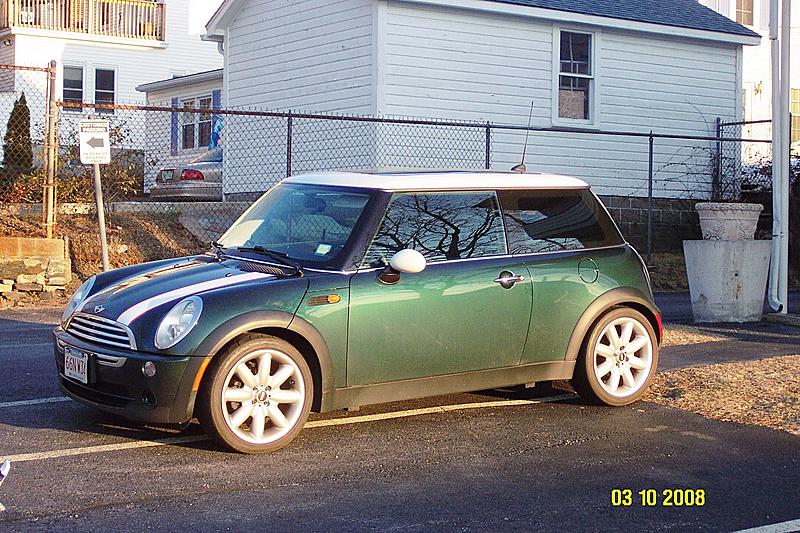

Old Jun 18, 2008 | 09:07 AM
05Greenie's Avatar
05Greenie
Joined: Oct 2007
Posts: 334
From: Webster, MA
Recently mounted General UHp tires that provide an awesome ride.
