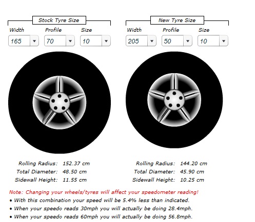

I've been offered a set of wheels that are made for GEM cars, 10", bolt pattern 4 x 4, but the tires on them are 205/50/10. Time to learn about wheels and tires.
Here's a visual of the profile difference based off 165/70/10 being the most commonly found 10" size used on sport 10" wheels like MiniLite and clones there of .... (what brand are the 205's?)
Visual copied from http://www.kouki.co.uk/utilities/vis...ize-calculator
GEM car ..... is the bolt pattern the same???? I dunno . . .
are these wheels even SAFE for road use?
or am I wrong about what GEM means?
IMO these are a white elephant . . . I don't see any Mini parts supplier offering 205/50/10 so something does not add up . . .

GEM is a golf cart, or neighborhood type vehicle, those tires may not be DOT legal, and they sure aren't highway speeds rated, I would stay away from them. You 'll also have offset issues and clearance issues. Best bet is to buy a set of wheels from a Mini parts supplier, and the correct tires. I run 165/70-10's on 6"X 10" wheels on my '80 Clubman Estate.
