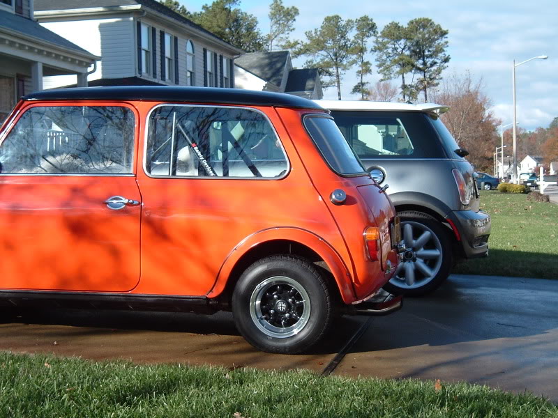

Here's something of a reference shot
The Mini is on 6x10 with 165/70 tires
The MINI was an 02S on the 17" S-lites with OE 205/45
the 10's result in an overall diameter of roughly 19 inches with a 3 1/2 inch sidewall. This is about the same sidewall height I see on my 07S with 16"wheels and OE tires 195/55. My 07 rides MUCH softer then the 02 did even when I compare RF to RF and non RF to non RF .... conclusion - sidewall height BIG factor. So if you change wheel diameter and overall diameter stays the same you must gain sidewall and I'd expect softer ride - but more sidewall flex if you drive hard enuf for that to be a factor. I don't track my car so it is not a factor for me.
and for note if as you say your current 13 setup has the same diameter overall as typical 10s and width is 5 - with the 6 inch wide 10's, altho you see wide flares on my car, behind the flares NO metal has been cut away and I have no rubbing issues. Wheel offset might be a part of this ... just a guess tho

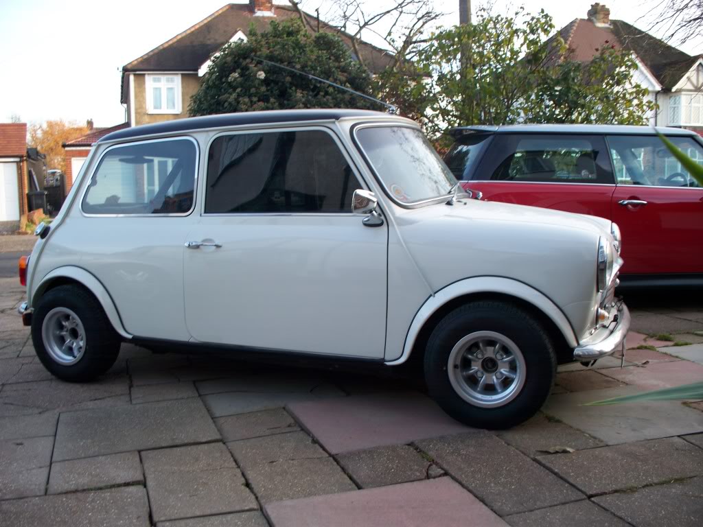

Swapped my 13" wheels for deep dish 6x10 ET-15 offset Minilite Mk 11, up to now rarely seen outside the Japanese Mini scene. My Mini drives so much better with 10's back on........just like Alec Issigonis originally intended!
