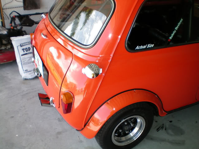

MK1 taillite mod
Originally Posted by elprofe
tail lamps are also unique, but some people upgraded them for better visibility, Now people tend to do the oposit (sic) to get that MkI look and feel.
Here's the MK1 tail lite mod on my de-bumbered and debadged...MK1 boot lid too...
