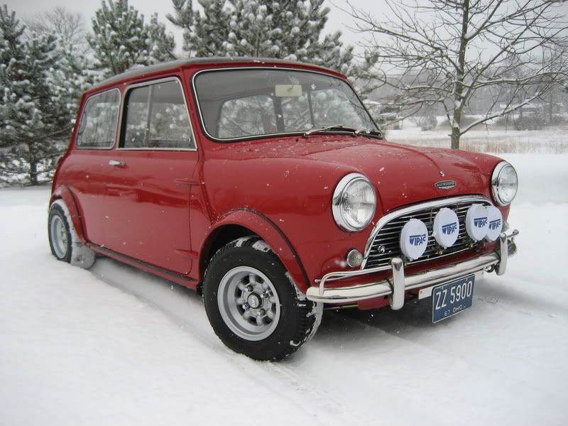

From: Powell,Ohio
Originally Posted by elprofe
you are looking fro something cheaper....you can get a complete bar with lights for that much from gbcarparts.com
Thats the set up I have.Wipac. I like them but had to make my own bracing to mount them at the top to keep them from vibrating when driving.
I used a 4 pole trailer connector so I could detach them when removing the grill.

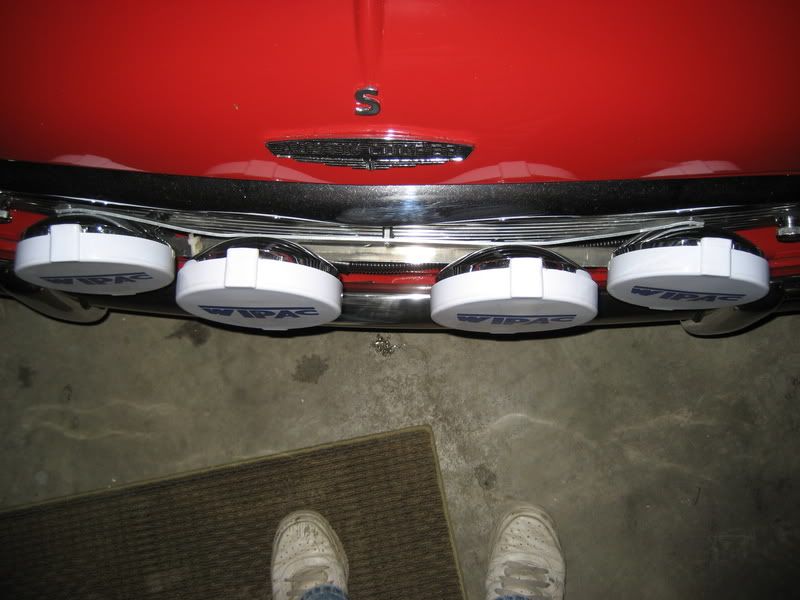

Your S is a BEAUTY! ( I like the snow-globe artistry too)
I've been looking at the WIPAC or similar setup too as I like the raised center light appearance. The bracket seems flimsy. How did you do the bracket bracing? Do I see a bar screwed into the backs of all 4 lights?

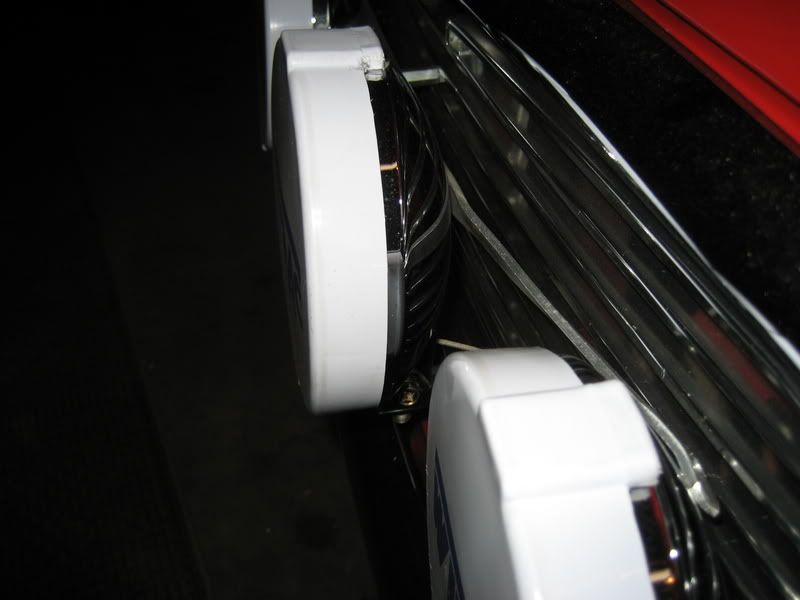

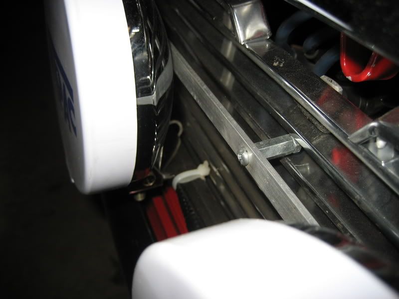

Thanks for the kind words.
Yes I made a flate alum bar that I pop riveted to the back of each light.This bar is then tied in to the grill.No shake.
I would like to see detailed pics of such bar. thx
Any particualer pics?
Nicely done! Not sure I have the talent to pull that off.
Not hard at all.It only takes a drill,pop rivet gun, 1/2 flat stock and exactly 3 Sam Adams beers.....4 if it is a hot day and your friend helps.

thanks....i see what you did....i guess the pics are not visible at work.
Aluminum stock it looks to be. Alignment must be a bear given the fixed covers ( if one uses the covers).

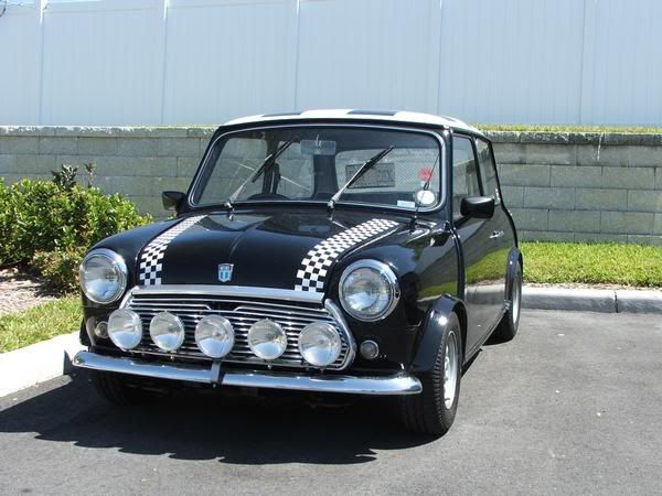

Big Norm's Avatar
Big Norm
Posts: 1,284
From: St. Petersburg, Florida
here is a pic of my old set up.....sure helped with visibility..lol
