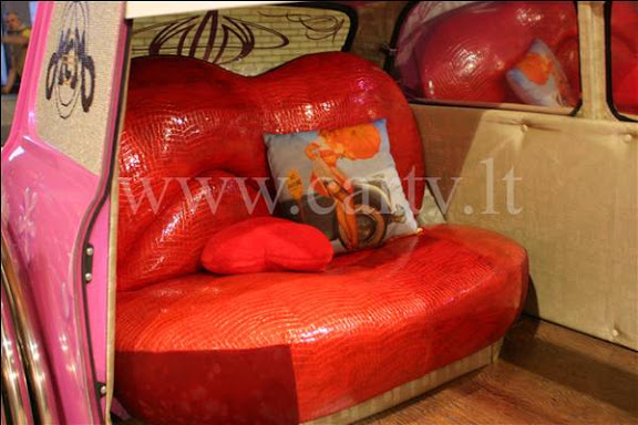

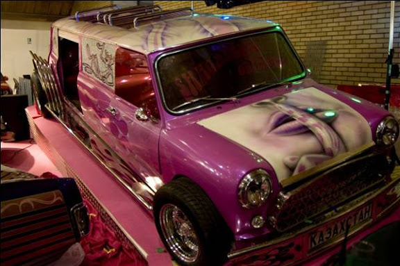

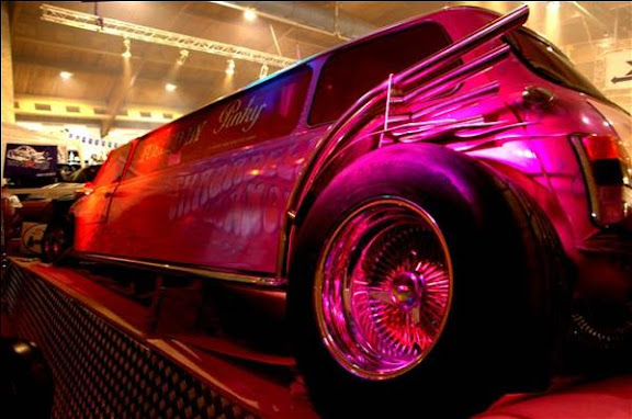

I found those pics when I was looking for Mini Limousines. I think this is the garage that made this mad mini.
The website on the last image I think is how I eventually came to find the sexy Russian Seems ironic and something that could get you killed in Russia to wear a UK flag!

I'm afraid to ask what that rear seat is supposed to be. And that hood graphic. Is it supposed to be whispering to us "Shhhh, this classy love limo is sneaking into a mini meet near you"?
LOL.. no idea why anyone would build this car There are pics of the build around on the Internet too.. The seat .... .uhhhh I guess you should be thankful there is no tongue sticking out the lips..
