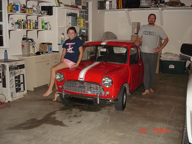

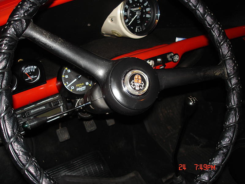

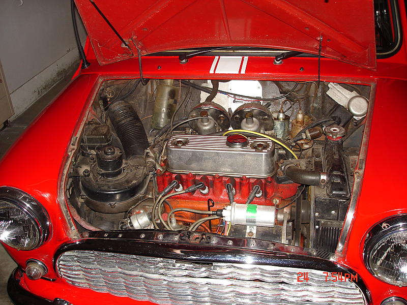

here are a few more.
And thats my daughter in the pic also, no rude comments!!!
