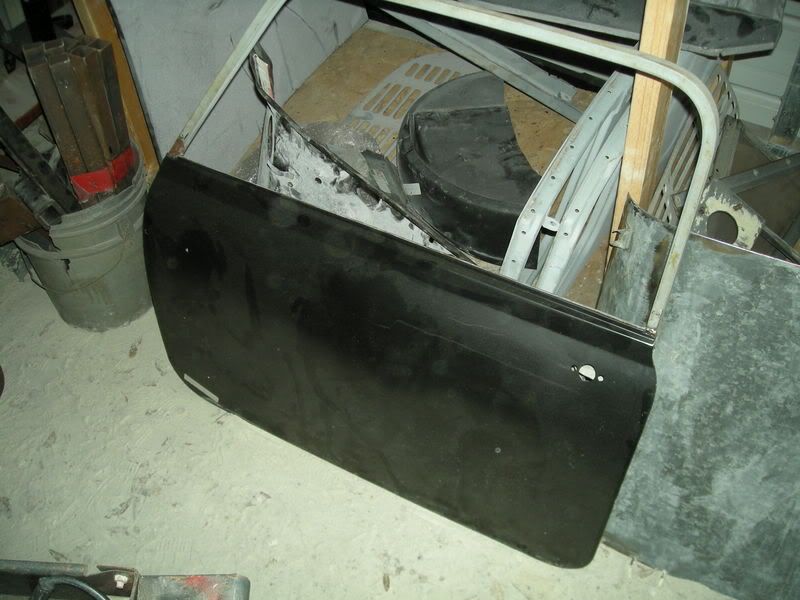

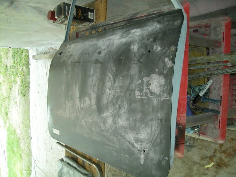

these are the only pics of a door skin i did that i have.....

There isn't much welding to a door skin. Just a few spot welds. Mostly grinding the old off and carefully folding the new skin on to the frame. As stratman says, the permanent cure is new metal. Filler will only last a year or so at best.
As far as your rust issue, is the rust part of the skin or down in the channel which is part of the door frame? This is common with older sliding window door. Sometimes better to get a good door frame to begin with, although repair sections are available. Here's a link to the channel pieces for a sliding window door.
