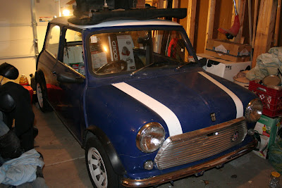

So, I'm in the process of tearing apart the suspension on my '74. I've got the left-side completely disassembled except for the driveshaft. Just need to work on cleaning up everything before I ask the local Mini guru if I can use his blasting cabinet.
Luckily the only thing I broke was the tip off my Craftsman pry bar (aka big *** screwdriver). Which oddly enough I don't think I've ever seen used for anything other than a pry bar. The plate on the end of the upper arm shaft was stuck to the subframe like no other.
Nothing was terribly difficult to remove either, altho the 2 bolts on the outboard side of the upper arm shaft weren't exactly easily accessible.
Replacing all kinds of parts (with commentary!):

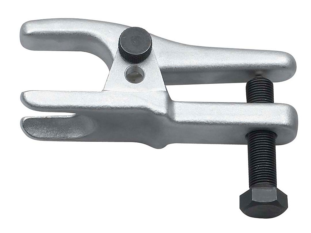

ball joints (buy one of these! best $ you can spend - couple turns of a wrench and kapow! it's seperated - pickle forks are for pickles!)

Just make sure you have one of these! - best $ you can spend IMO.
Is that a shock compressor? Or a cone splitter, or what?

it's a ball joint separator - ordered it from www.sears.com
necessary to separate the ball joints from the suspension arms
