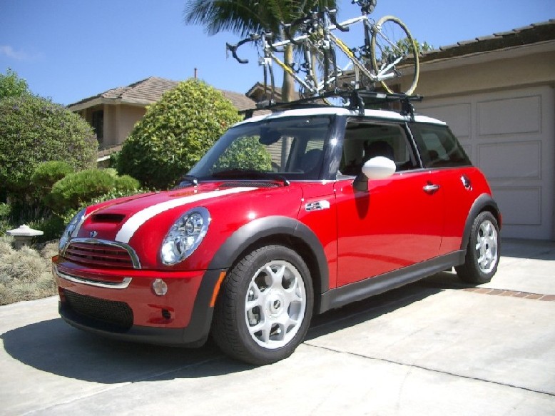

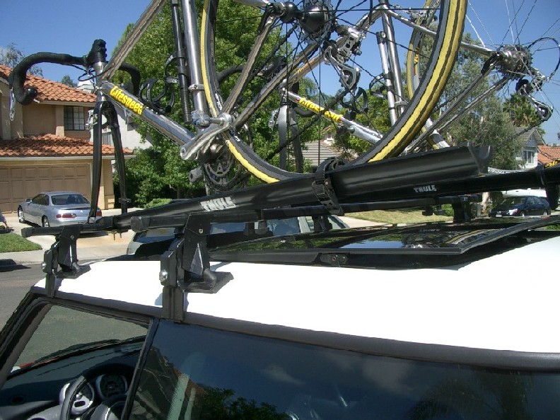

Dustin,
I finally cleaned up my old Thule rack, installled the MCS fit kit and put the whole thing together. Attached are some photos of the finished work.
I moved the front cross bar back about 1.5 inches and expanded the distance between the cross bars to 25 inches with the rear cross bar behind the front door jamb to give extra clearance for my sunroof in the tilt-up vent position.
By-the-way, I was pleased to find my sunroof is fully functional with the Thule roof rack clamped in place and holding two bikes.
Thanks for your pointers.
Gary

I had the factory system and ended up removing it and respraying the top..... your Thule looks good .......
FWIW "Moskito" (Herbert) is like the sales manager, or general manager of Litespeed.... he gave me a complete tour of the factory (near Chattanooga)..... very nice guy and even though we have not heard from him lately, is really into his Mini
