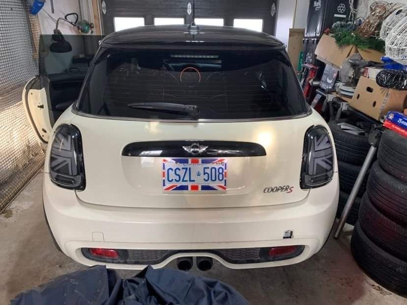

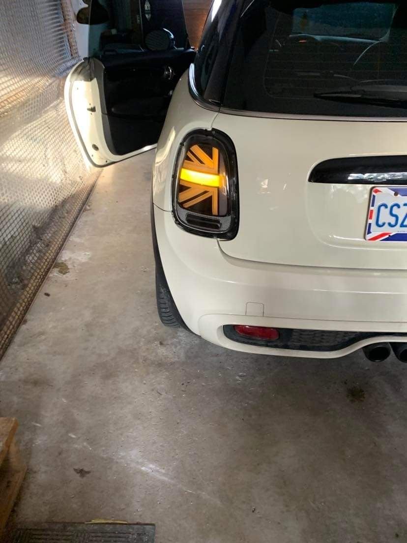

Lights won’t lite up
how do I get my lights to lite up when I turn my light on.
I’ve kinda got part of my signal light working and half a break light.
the Union Jack doesn’t light up at all.
im new to BimmerCode and could use some serious help please.
