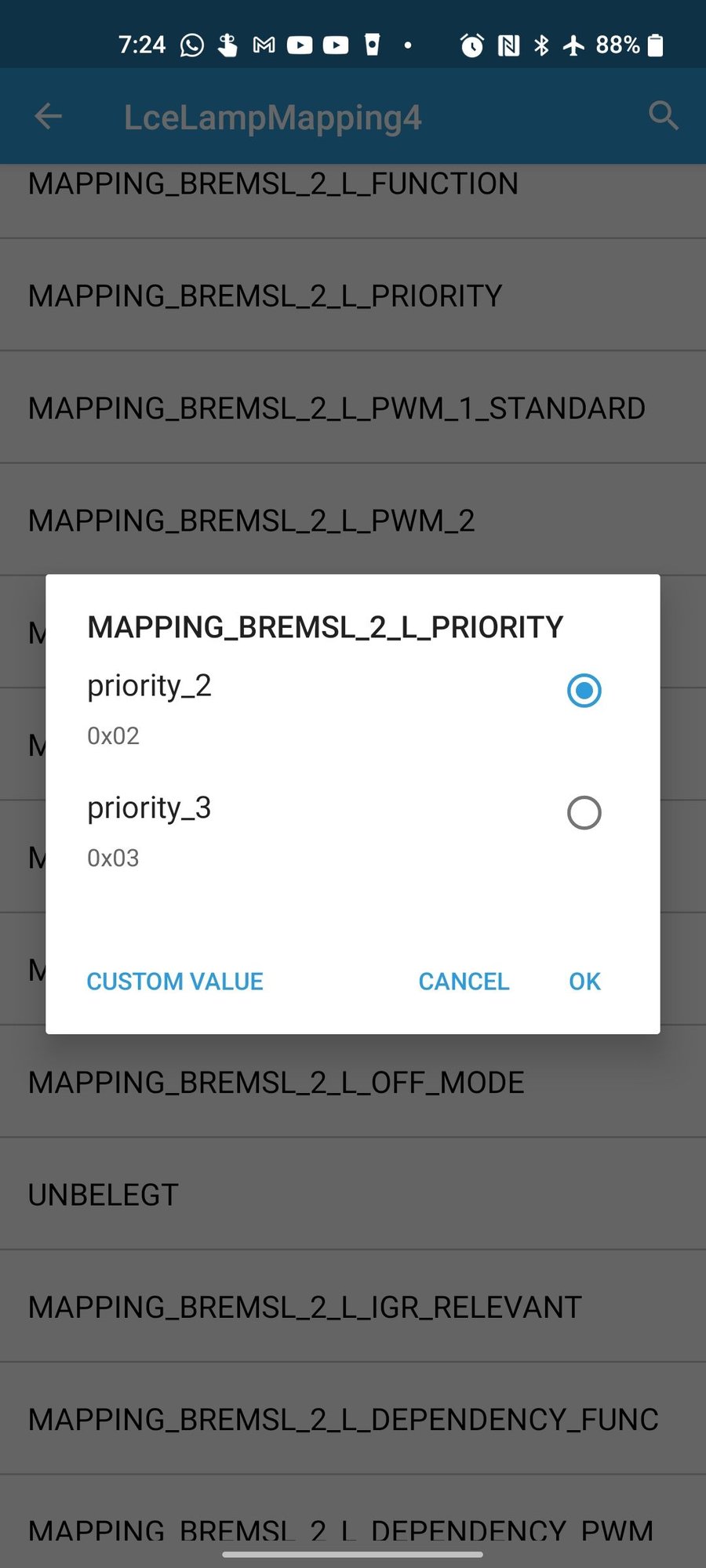

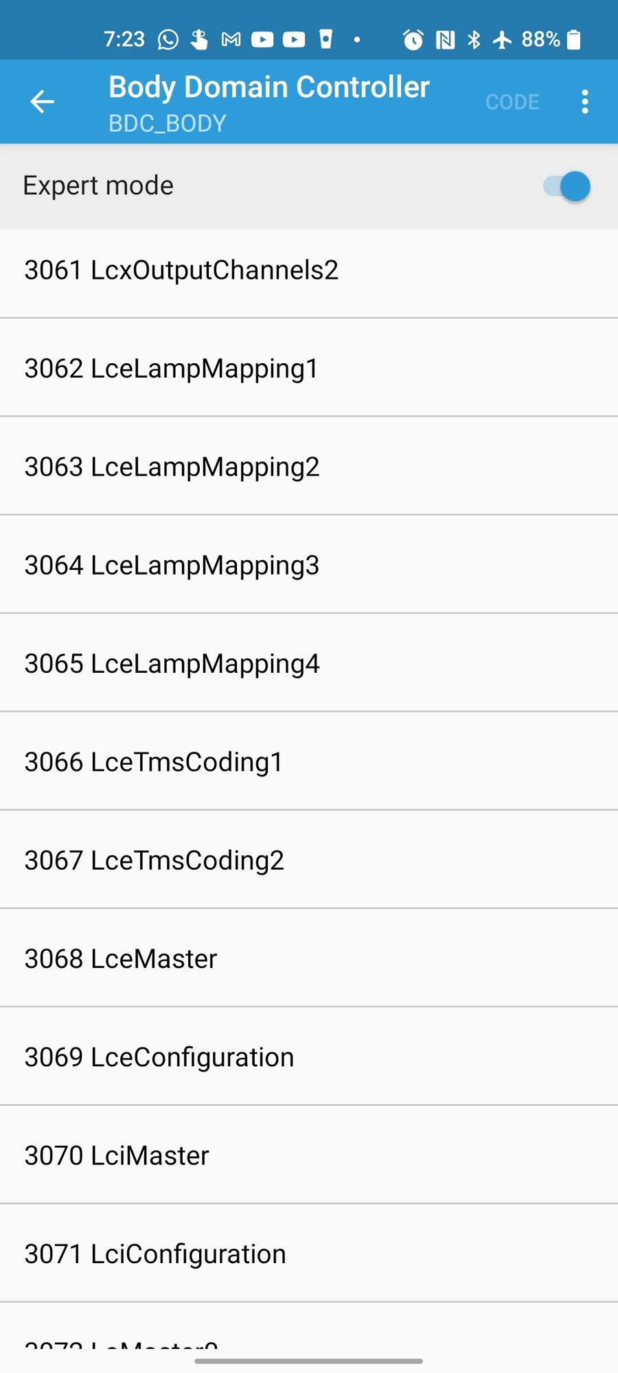

UJ tail light coding for F5x is not the same as F60
bought the US Spec UJ tail lights for my 2019 F60 (preLCI) .
my original thread is here : LINK
i dont see the specific codes in order to make the turn lights take priority from the Brake lights when both are applied.
digging some codes in the bimmercode app, I can assume that this are the codes that need to be addressed?
I havent tried it just as yet. As I'm squeezing time between work and family and dont want to mess up my car coding.
Advise and help needed.

I started troubleshooting your screen grabs and wondered why they dont follow dunkMs guide - that worked for me.
The i saw the car you are working on. F60!
Within the detail of LCI/non LCI/Euro and USA and official OEM and Chinese knock offs theres a path for most combos- but for F56s. You may be the first trialling this for F60.
Maybe build on the archived Union Jack retrifit story ./f56 known codes with a sub section for /f60

I’m trying to follow DunkM’s post, but I’m not getting the correct result. I welcome any and all suggestions.
I’m in Canada and have a ‘22 F56 base model LCI2 that came with OEM Union Jack tail lights and I’m trying to install the European/UK Union Jack tail lights (with amber turn signals). I can install them but I can’t get them to use the horizontal part of the light. I don’t get any errors at any point in the process, even without any coding.
The result I'm seeing is just the vertical light being used for the turn signal and brake light. The UK lights basically behave like the US lights, just without the horizontal bar. (I've attached videos below.)
The wiring harness has six wires for the connector so I didn't re-pin anything. Should I still re-pin something? What am I missing?

I have tried a few things, restoring from backup before each:
  1. No coding (I don't get any errors)
  2. DunkM's post verbatim (Initial coding + EU specific)
  3. The following
Here's my last attempt, along with the stock/default values, for context:
