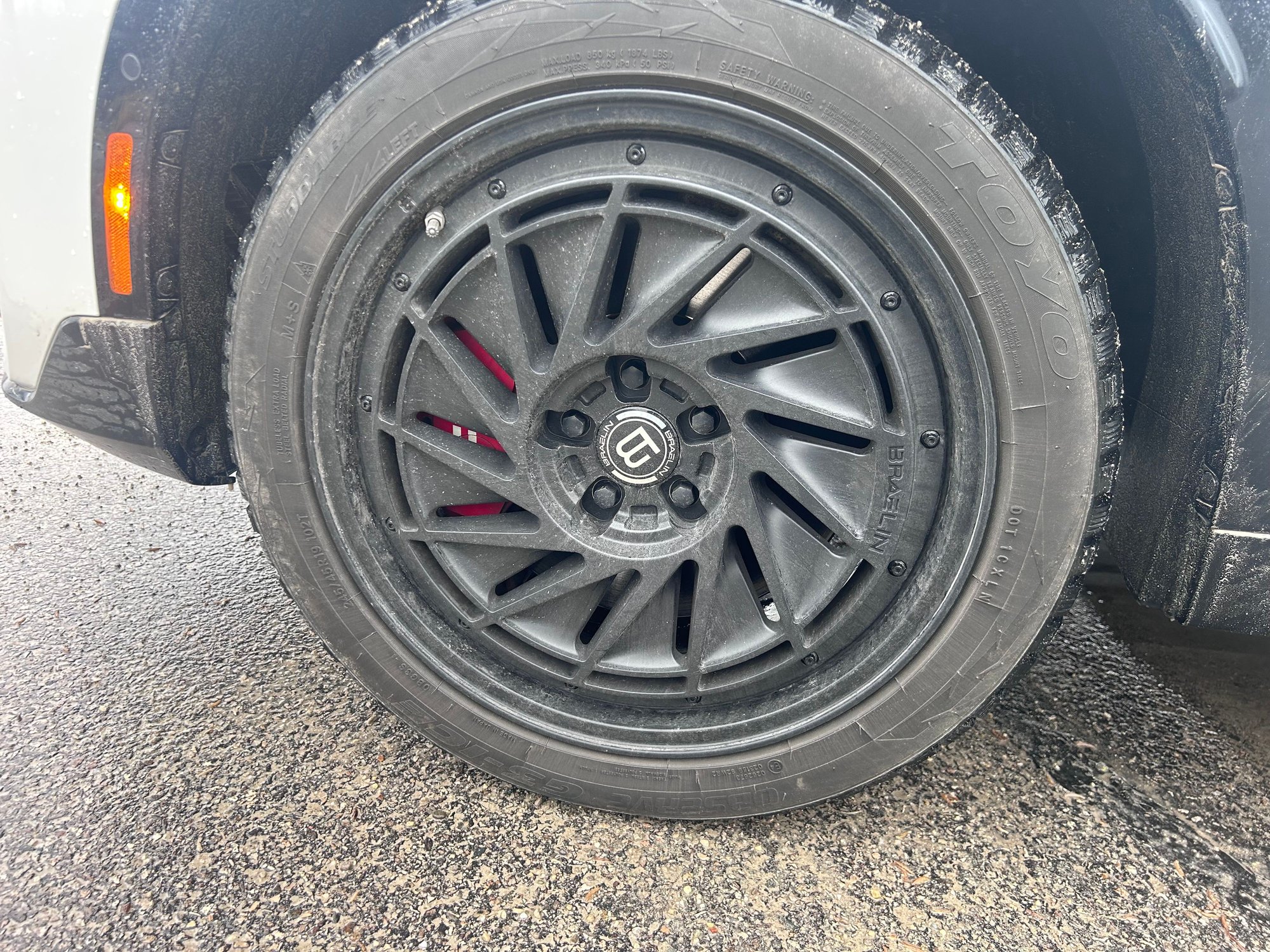

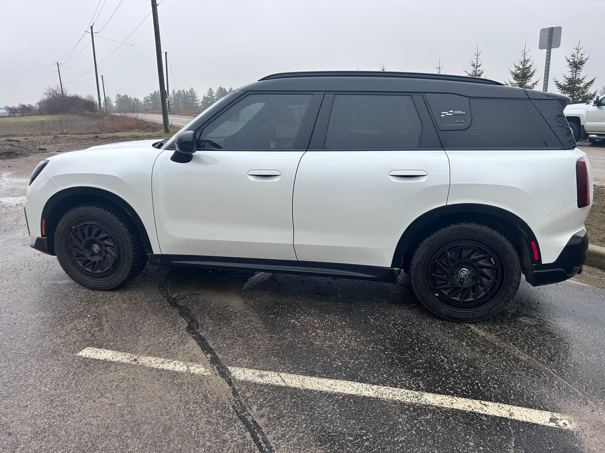

Never go to a dealer unless it’s needed, they price gouge. You can find your own setup for half the price a dealers rapes you for!! I ended up with a set of 19” Braelins wrapped in some premium Toyo Rubber.
