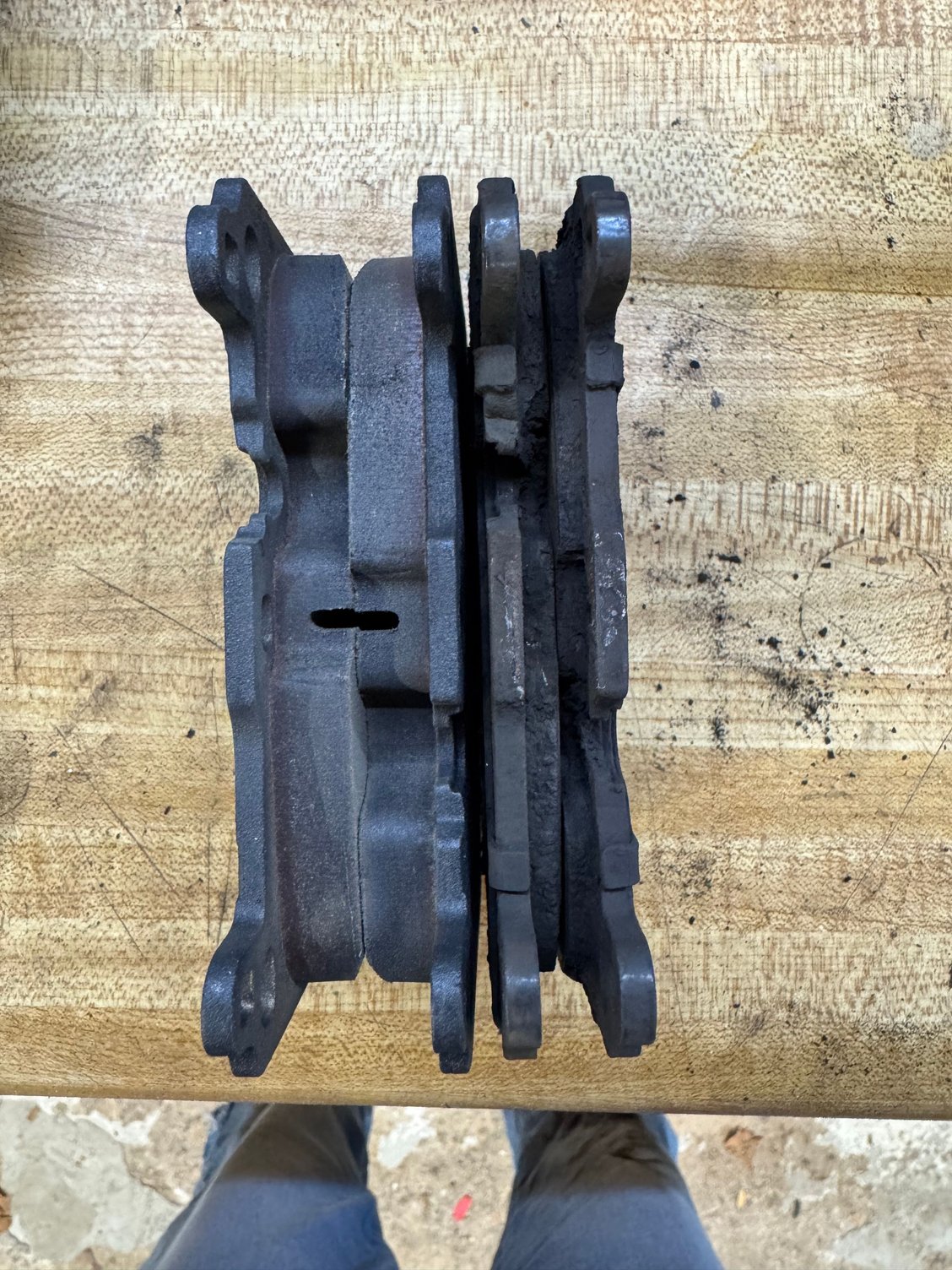

Man at least for mine, you're underselling the "worn to trigger". I finally pulled the brakes off and that sensor was mangled.
