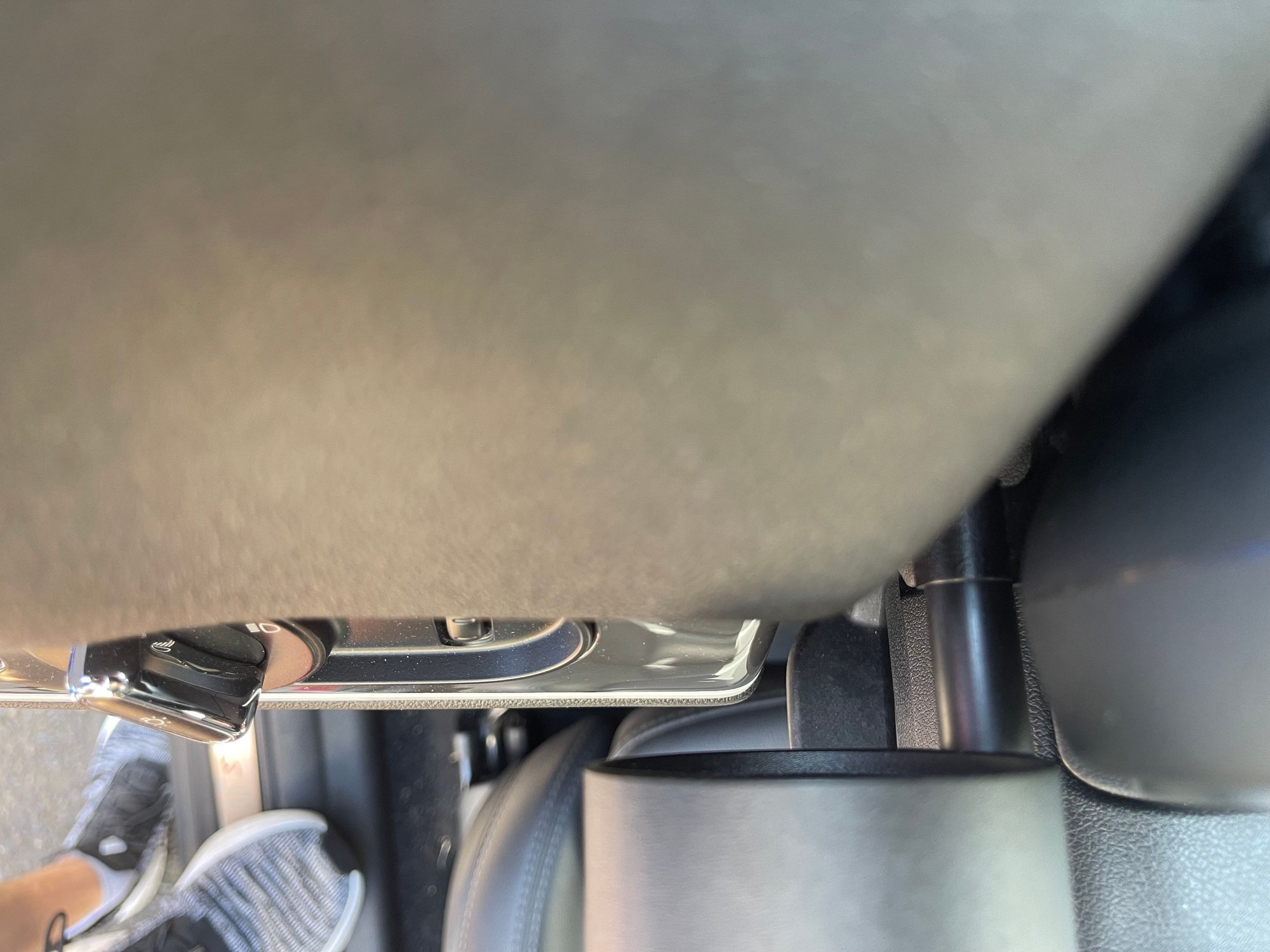

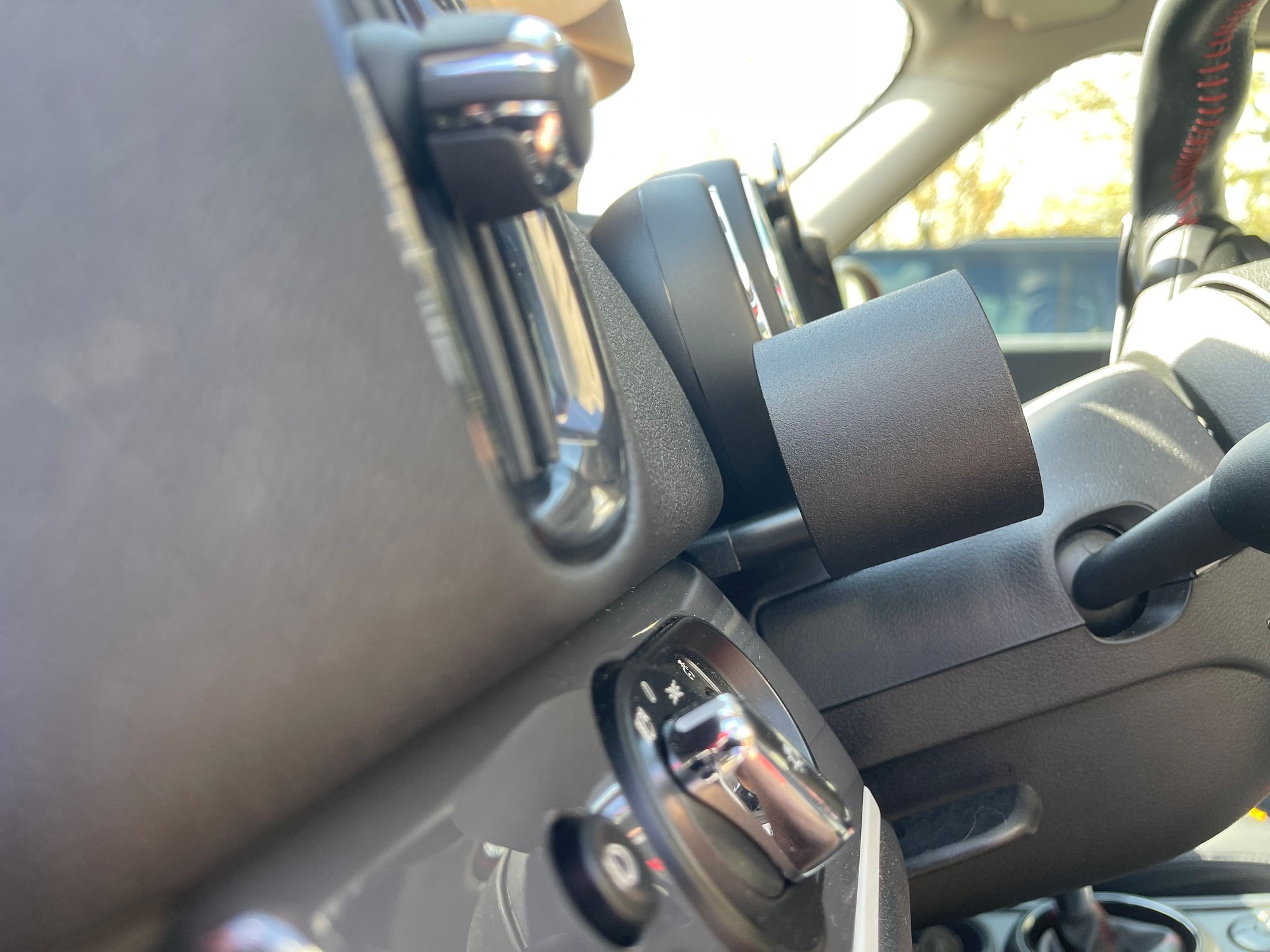

Hello NAM! We have been in communication with the OP about this and we took the time to get some photos of this installed in one of our own F60 2019 Countryman All4 S. Here are the photos we shared with the OP. Let us know if you have any direct questions, please.

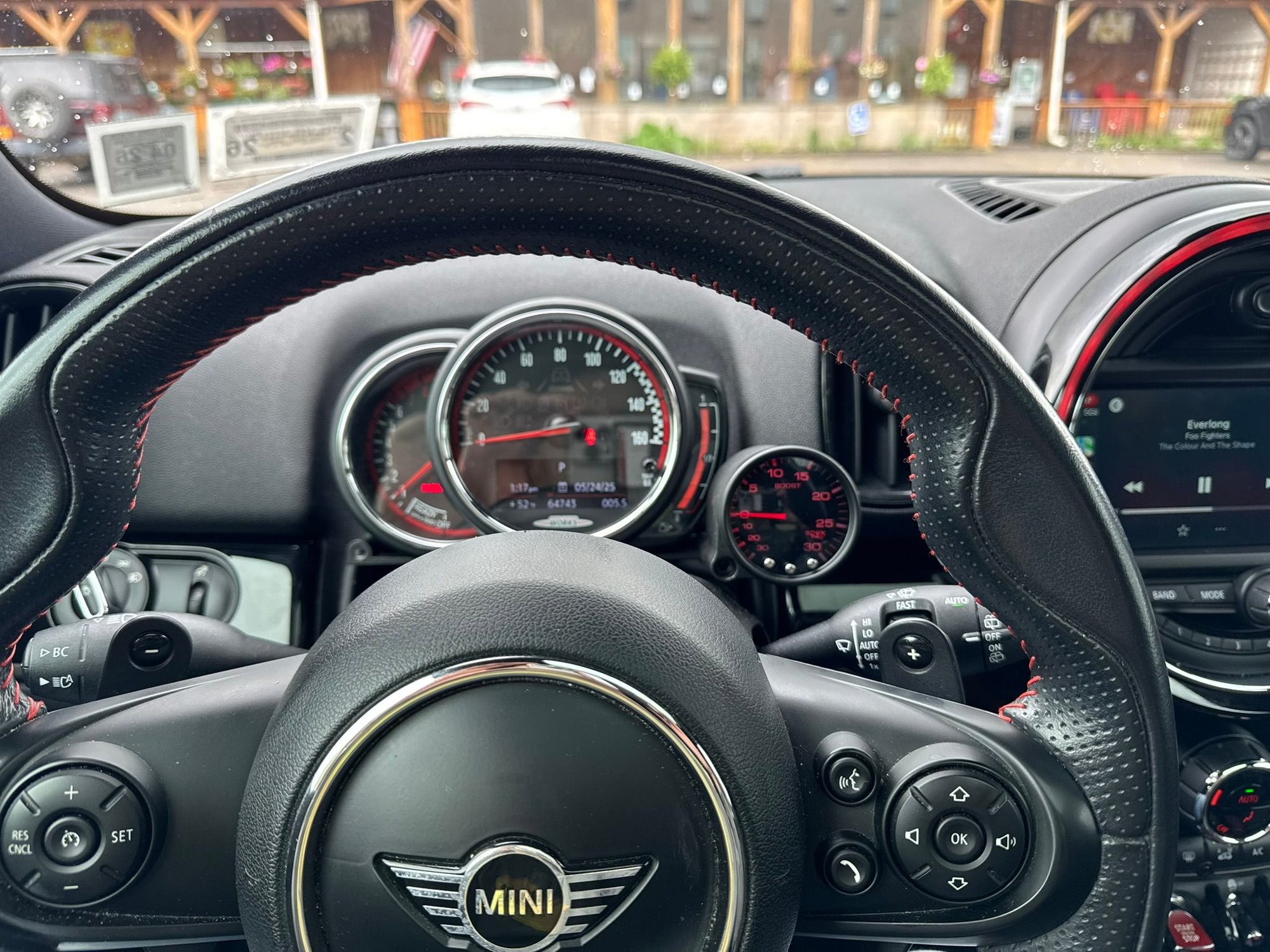

Gauge has been installed and running for about a week now:
I prefer this gauge placement over any of the higher dash mount locations. My car has the HK stereo, so the center dash top gauge mount wasn't going to work for me either.
One thing I do not like about this mount... It vibrates, like a LOT. I had to shove some closed foam insulation in between the gauge cup and the steering column trim to get it to stop. I don't know if there is anything CravenSpeed can do about this. Seems like its just part of the location. Since the gauge cluster is cantilevered over the steering column, and then the gauge mount is cantilevered out from the gauge cluster, any little bit of vibration that comes through gets amplified by the gauge cup.
On the other end, the CravenSpeed boost tap mounted up without issue. I didn't get any pictures of that install, but if you've seen one, you've seen them all.
