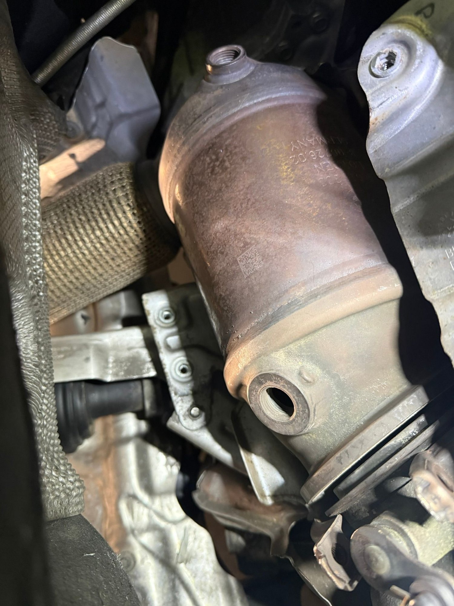

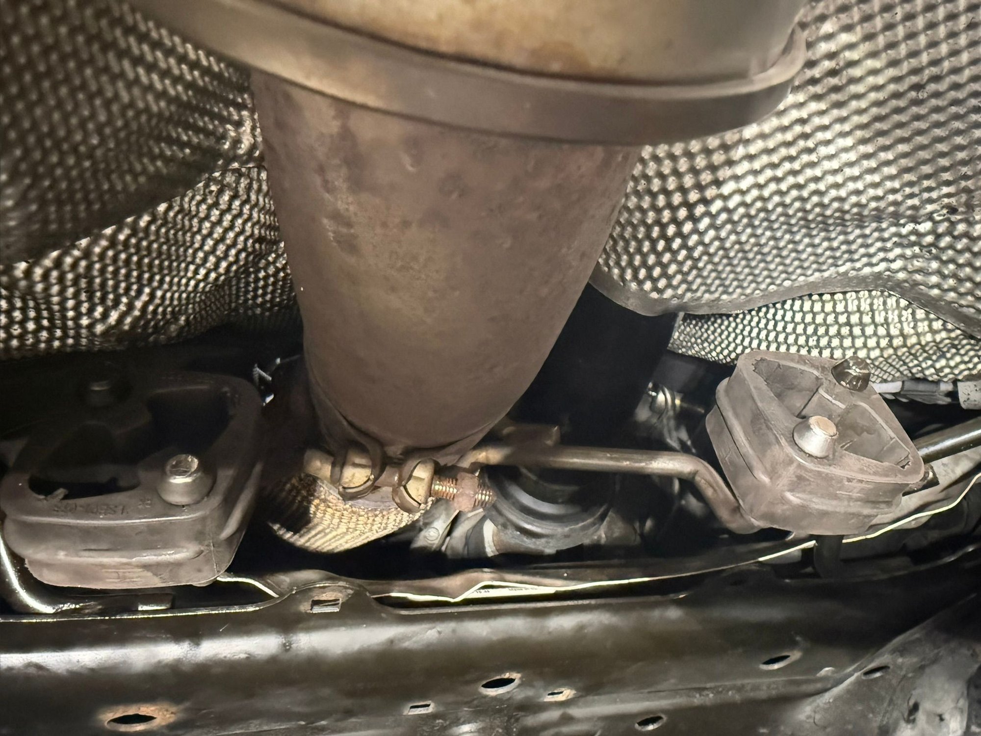

so Lads , i received the downpipe , unfortunately it was exactly as North 60 described .
the process for it was quite easy and quick , i mean the access for the upper clamp and the stock catalyst it was around 30 minutes for me ,
just removed a few bits around engine bay , BUT! transmission block the stock downpipe for removal due to the hangers cant pass through the bay , the engine bay space it is quite enough to remove the main body of the stock down pipe , but its just stuck on the lower end of the downpipe , i did a small research around here at my city at the locals exhaust repair shops , they couldn't accept the job , so i will do a bit more research of exhaust repair shop , or i will return it back ,cause at the end of the day , if the installation cost will be more that the part , it is quite useless upgrade for me .
it is very annoying cause initially it looks very quick and enjoyable DIY , with minimum tools and even mechanical experience .
for sure the F56 and f54 without ALL 4 system i presume it will be peace of cake at least for me ..

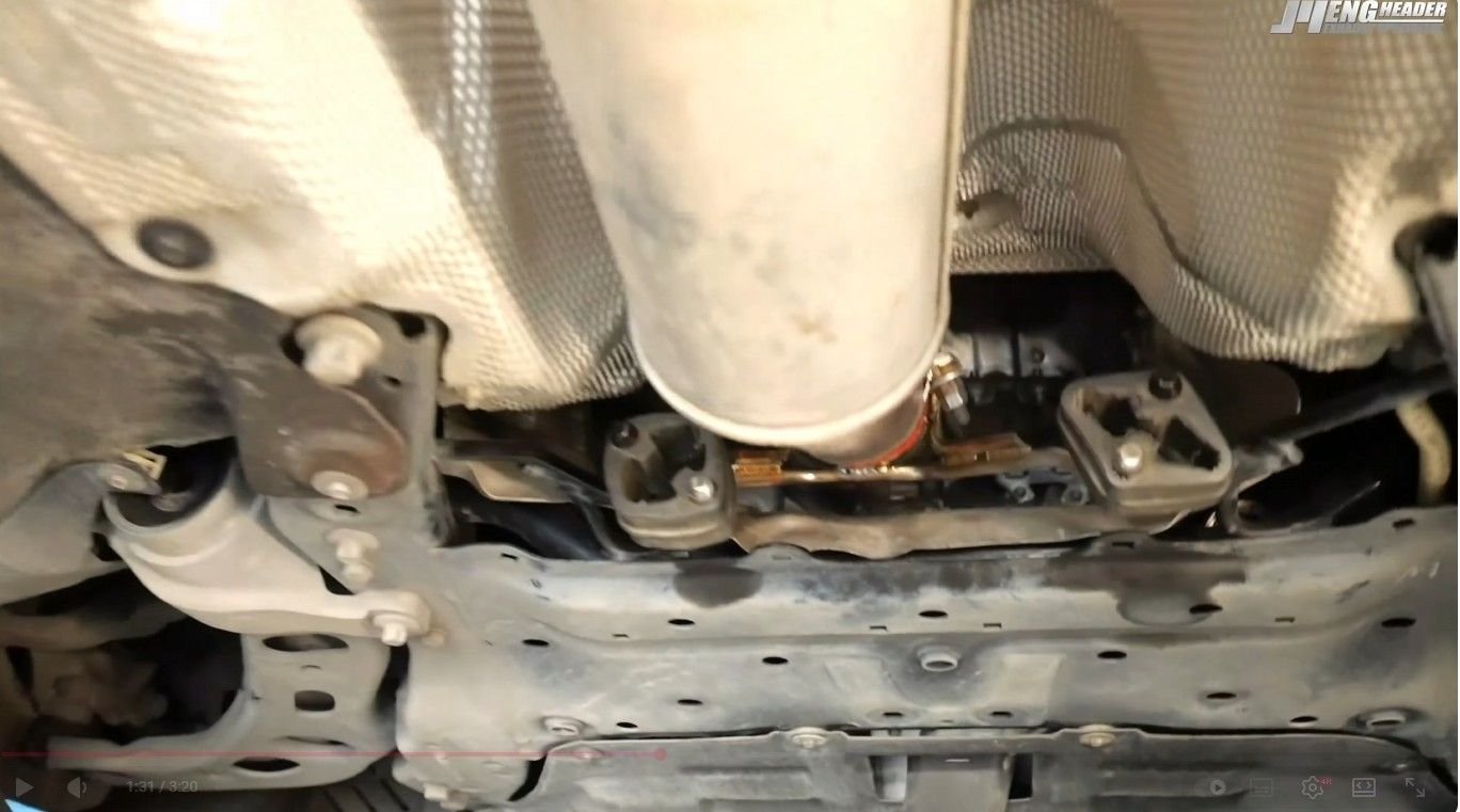

just to mention the problem , non 4 all and 4all issue .
