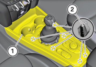

Hi guys,
I'm a beginner MINI.
I have a little bit problem with the CUP holder like the picture below.
(Holder went inside)
I searched for a way to remove the center console and cup holder but I couldn't have found it.
So, I seek help.
There is a problem inside the red circle!
I want to way remove the RED BOX.
Thank you in advance.

Just reviewed the instructions again....
1) remove the shift lever - start by pulling up the shift boot as you have in the picture. There are several wires and connectors depending on your model. Instructions say to also remove the ****, but you can probably rotate the center console when loose so that the cupholder is over one of the footwells in front of the seat.
2) remove the figure 8 ring around the cupholders themselves
3) the console is held in by 6 spring clips you pull it up and it should gradually unclip, start at the back because it looks like the front may be under an overhang. Gentle and not too much angle as it is the type of clip that is a small protrusion of plastic from the console with a bit of spring like metal over that. Similar to many of the european car clip styles. See the #2 inset. Note there are also several sets of wires for the selector **** and electric parking brake.
4) the cupholder is held onto the center console by 4 screws sent up from the bottom side of the cupholder into the bottom side of the console. So no way to get the cupholder off without clearing the bottom of the console so you can get to the 4 screws from underneath. Screws are at approximately 2 o'clock and 6 o'clock for the right cupholder and 10 and 6 o'clock for the left one.
I may try this, once I get the console loose I will try to rotate it out to one side and get enough clearance to get a screwdriver up underneath to remove the screws. May take awhile before I try this, temps are too low to stay out for long, 20F and less.

Mar 4, 2023 | 07:55 AM
Nice job! Thank you for the write-up and pictures.
With the images and write-up, you can quickly see the missing pivot/tabs when you take off the top "8" cover. The arrows point to the empty holes where the tabs should be and at the bottom of the image you can barely see a similar round hole, but filled with the tab pivot point (no arrow).
Thanks again!
