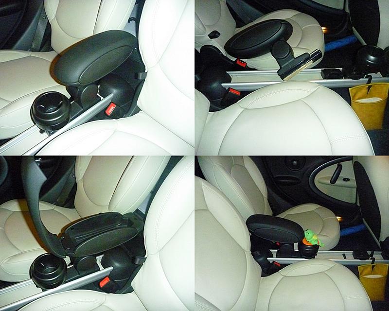

I removed the armrest as well. I mounted it to a piece of 3/8" plywood that just fit between the rails with a glued on ship that fits under the rail attachment gizmo from the useless phone holder. That clamps it in and holds it down. I used one of the rubber rail dividers to keep it snugged up.
Crude but effective until I come up with a better fix. You can position it anywhere on the rail.

Nice modification! Sounds interesting... Perhaps a picture when convenient.

Here is a picture. I turned the armrest around so it fits back between the seats. When I have time I will mount it to something thinner to get the height done to normal. It will go anywhere on the rail and DOESN'T rattle or squeak.
When in the rear the seats will fold down, but, you can't use the flat floor option. Easy - take it out and put in rear foot well.

Very nice. .Hopefully I'll have the one in for the rear seat passengers by the weekend and I'll post some pictures as well. So thats the armrest w/o the cradle and wiring ?. I have one due in any day from Outmotoring.
Nice effort!!
