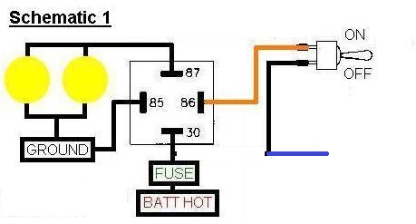

I've not done for F60 but have installed several MINI kits on GEN1 and GEN2 cars so don't expect things to be very different. The factory kit is $$$ and VERY COMPLICATED to be 100% street legal everywhere which ALSO makes the operation of the system complicated. Others familiar with the topic know it is common for folks who bought used with the aux driving lights to believe they are busted when they can't figure out proper operation. After my second kit I could knock one out in about 2 hours. First time .... argh and do even THINK about trying without a set of factory instructions. <I have for GEN1/2 installs but could not find for F series . . . at my regular source>
When someone asks me for a recommendation I say get some brackets from a place like Craven (unless you have a friend who can cut and bend some flat stock as brackets ain't rocket science) and a generic driving light kit like PIAA or Hella. These typically come with a a generic wiring harness which consists of wire, an inline fuse, a relay and some sort of a switch. Or you can get such a wiring kit at any parts store for no more than $20. You can add fog/driving lights to any car truck with a kit like this for a FRACTION of the cost of the MINI kit and the wiring stays SIMPLE.
Here's your basic wiring plan
the numbers on the relay are STAMPED into the plastic ... don't worry about what they mean ..... This is the simplest version of the wiring and the lights are fully under control of the switch
The secret to altering how the lights are controlled come from the line from BATT HOT to the switch or that is, where terminal 86 gets its power. If 86 is HOT they the relay sends juice to the lights (accessory); in the diagram above 86 gets power direct from battery (via the switch) so even with ignition off if switch is ON lights are ON.
Move this connection to change performance .... see blue line
connect the line from the switch to the high beam trigger line and now the lights will ONLY activate if the high beams are on. Move the line to a circuit that's only on if ignition is on and lights can be on so long as ignition is on no matter what high beam condition . .
feel free to PM with questions
