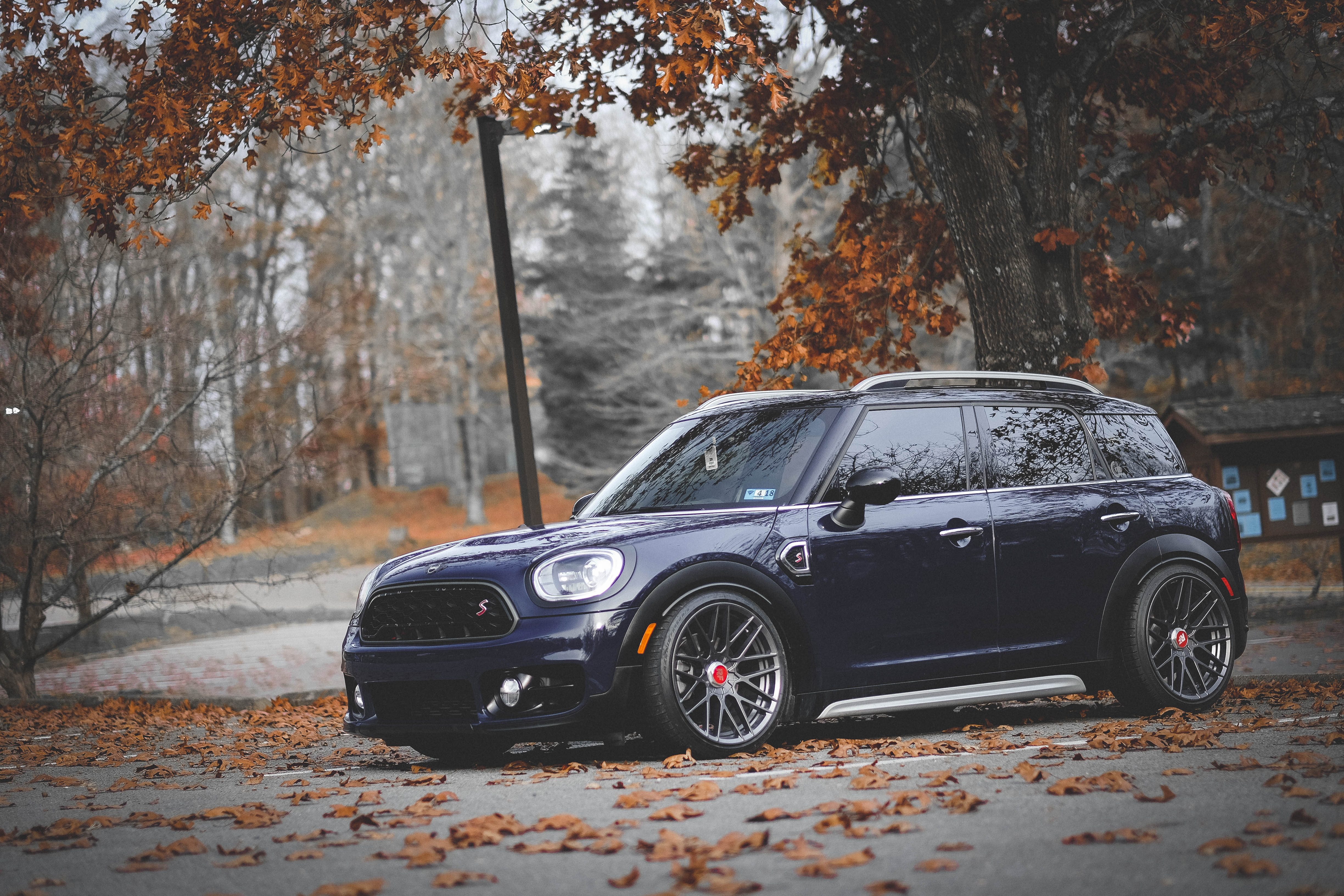

Let's hope the F60 JCW brake upgrade isn't as sorry as it is for the R60, where it's essentially just a coat of red paint on the standard OE slider setup.
So as not to leave this to chance, my buddy and went to work on a custom F60 BBK that uses a Telsa rear electric parking brake so that both front and rear ends can run fixed/performance calipers for the active units. However, that little project is less 'compatible' and more 'custom'. Suffice to say, I'm chomping at the bit to get it completed.
FWIW - Some of the F30 suspension parts are 'fittable' to the F60. The rear dampers in particular have the same attachment points and are shorter, making them perfect for a lowered F60. In short, you can likely use a coilover kit for the F30 and simply source a few bits to change out and you'll have a baller/adjustable lowering kit for the F60...

Originally Posted by CG1*
So as not to leave this to chance, my buddy and I went to work on a custom F60 BBK that uses a Telsa rear electric parking brake so that both front and rear ends can run fixed/performance calipers for the active units. However, that little project is less 'compatible' and more 'custom'. Suffice to say, I'm chomping at the bit to get it completed.
Complete.
Old Jun 3, 2019 | 01:46 PM
JDWatts's Avatar
JDWatts
Joined: May 2019
Posts: 25
Likes: 9
They look pretty awesome!
How is the pedal travel? Engagement point?
Are they more touchy/grabby than stock on initial application?
pic stolen from CG1*'s post
