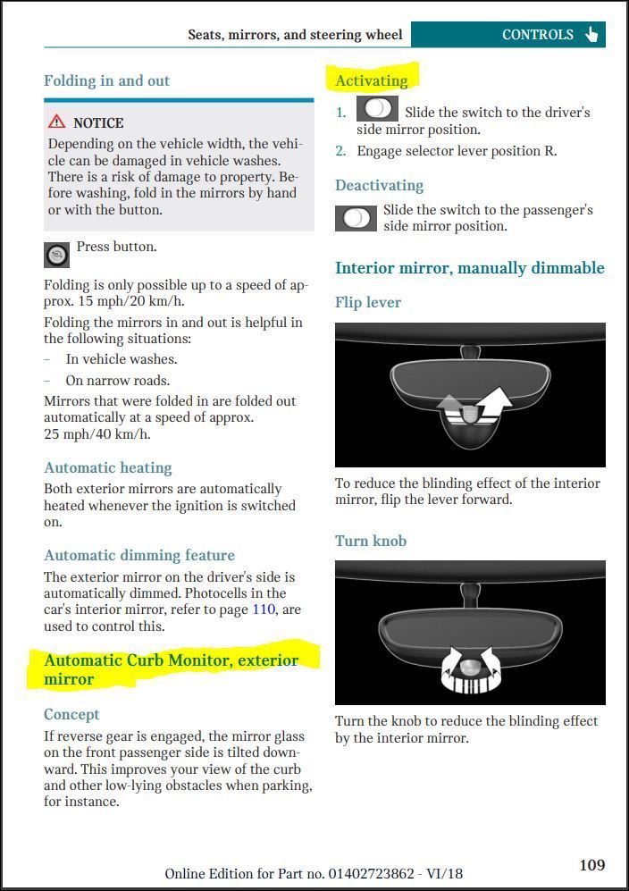

Is it possible to stop the passenger side mirror from "looking" down in reverse?

This is controlled by the mirror selection button just above the window switches on the driver's door. Slide the mirror selection to the left to disable the automatic down pivot of the passenger mirror when in reverse. Slide it to the right (passenger's side) to re-enable the feature.
Ooops! I had the switch positions reversed. BossHoss had them correct of course since he is showing the manual pages. In my defense, note the Activating and Deactivating show the slide switch in the same position.
