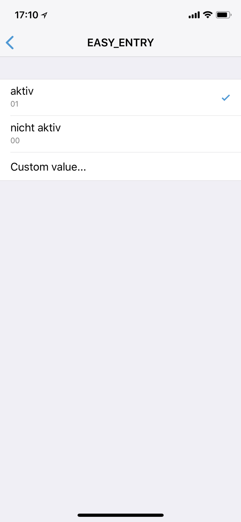

Haven't found anyone else trying it on the Mini. I dit ry to code it.
There are 3 settings and all three are as I recall it in the SM2(D6) module, there is also a SM2(E6)(probably passenger side On mine 7) module but in that module I could not set the value for EINAUSSTIEGSHIELFE to "Modus_FA_SLV".
3000 SM_GLOBAL -> EINAUSSTIEGSHILFE = "Modus_FA_SLV"

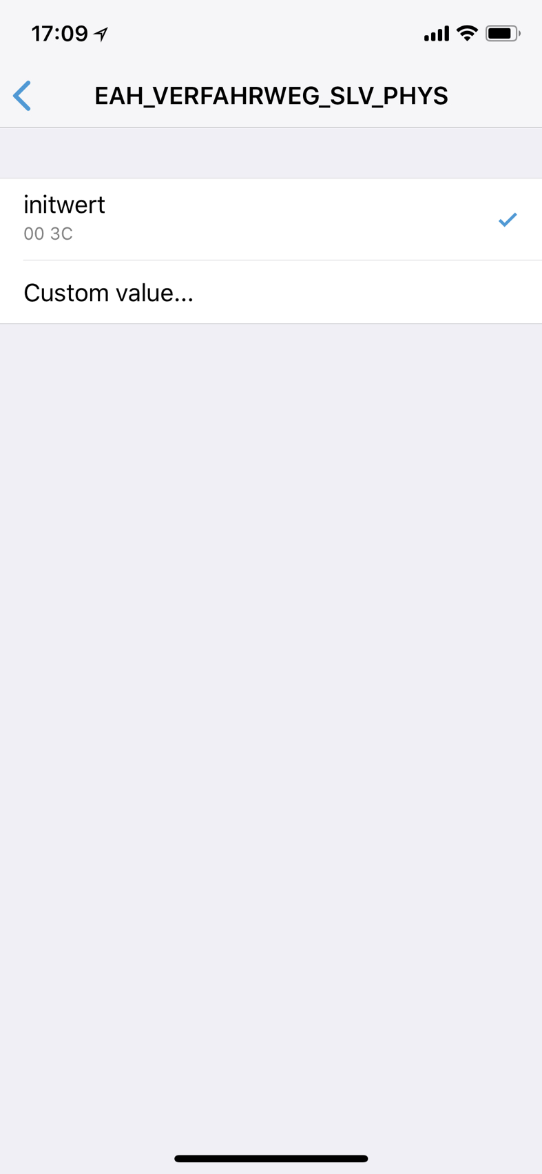

But on mine, i can't find these 2:
3012 EAH -> EAH_VERFAHRWEG_SLV_PHYS = Werte=00, 28
3012 EAH -> EAH_SCHUTZFREIRAUM_HINTEN_SLV_PHYS = Werte=00, 3C
3012, seems not mapped. Anyone else who has it mappen on their countryman?
It didn't seem to work at all, but like others strangely when i tried the car with my second key, it did work. Very strange. When i open my door after ignition off, seat moves back. When i enter and close door, it moves to memory position.
I also activated gentlemans function which doesn't work for now. And also put these codes to activ:
EASY ENTRY: Activ
Now i will try easy entry TTB also.

What have I not set correctly? Is it my wert settings? Where did you get your values from? I'm using BimmerCode (Expert Mode):
Attached Thumbnails Easy Entry Electric Seats Moving back while exciting, forward entry?-photo884.jpg   Easy Entry Electric Seats Moving back while exciting, forward entry?-photo825.jpg   Easy Entry Electric Seats Moving back while exciting, forward entry?-photo14.jpg
